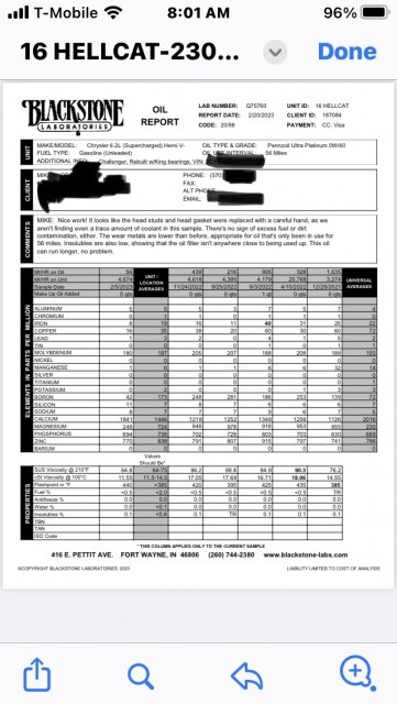

I just dumped the PUP 0W40 start up oil last week after head gasket and stud change, oil that probably didn’t have 100 miles on it because I wondered what the antifreeze contamination level may be like in it and didn’t want to keep running it as I have been waiting on a oil sample report to return asking such about the oil to only get the report 2-3 hours after I was done saying the oil was perfect ok to continue running it as it didn’t even have a measurable trace of coolant in it. How many shops take that much care during a head gasket change to not get a drop of coolant in the oil system?? Yes, I’m anal lol but you have to be at these kinds of power levels.
This was not an easy 56 miles lol, probably 20 or so 60-130 runs in that 56 miles lol.
PS, the oil in prior tests is Amsoil 5W50 Signature Synthetic, additive package differences between it and the PUP can be seen in the report, it’s back on the Amsoil 5W 50 again now, I just used the PUP for start up oil because it was cheaper and I had it around.
