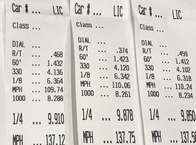

Speedy..., My first time out with the 3.09 315/50-17 combination and adjustable control arms (Spohn) with alignment. 0473A4B0-3B73-4F53-A48F-146E45511285.jpeg

Speedy..., My first time out with the 3.09 315/50-17 combination and adjustable control arms (Spohn) with alignment. View attachment 19866
My absolute favorite mod was a gift from my husband/ Top Cat
309 Gears! My Hellcat Charger was the 1st Charger to have them installed!
