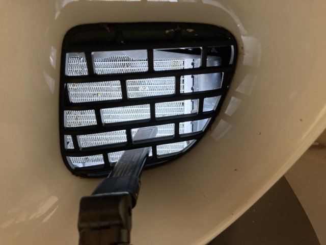

Today I gave @DGatzby 's suggestions serious study and consideration and realized a huge erroneous assumption I had made.
Often I look at the HC because it is in the garage and closer/easier to look at than the RE out in the barn. I assumed the air intake was the same, they are NOT!
Behind the lower left grill of the HC is a radiator, just like the lower right and lower center. This will warm the intake air before reaching the air box.

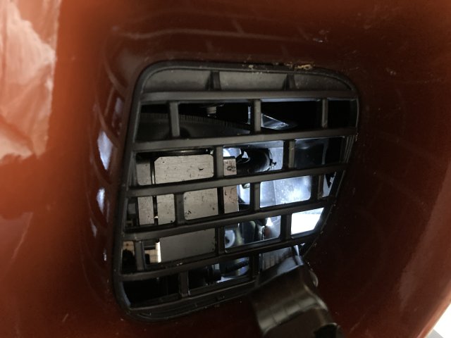

The RE has no such radiator in that location, it only has what looks like a valve body partially obstructing the path. It appears that the RE gets plenty of cool air and my idea of opening the 2nd scoop is not warranted.
Given this, I would only consider maybe opening up the right scoop on the M6. I'll have to give more thought to the RE. Maybe perhaps blocking the grill to the wheel well to increase intake pressure? I have all winter...
Thanks D!!!

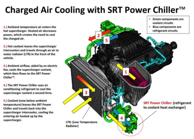

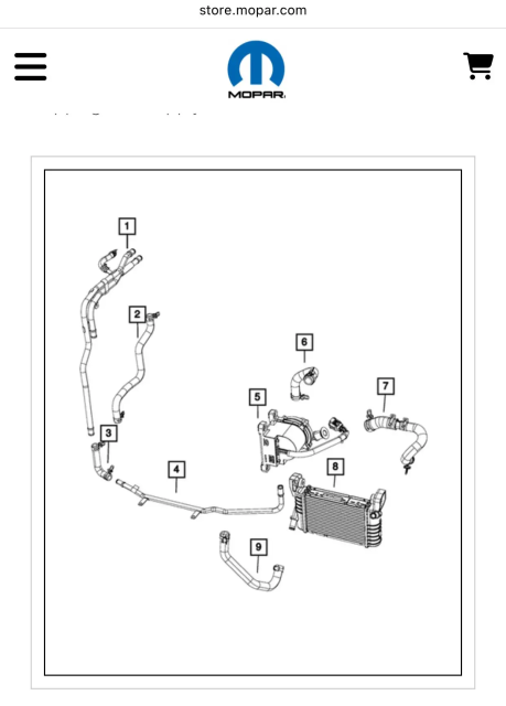

The hood changed from double-vented with air over the supercharger (2015-2018) to Airgrabber (2018 Demon) and two-scoop design (2019+ Hellcat/Redeye). As a result, the SRT Power Chiller replaced the small low-temp radiator location and replaced it with a larger low-temp radiator in front of the main radiator. Another benefit was air going up into the airbox was closer to ambient vs pass through small radiator.
2015-2018
Low-Temp Coolant Pump and Radiator
2018 Demon and 2019+ Hellcat/Redeye Low-Temp Circuit Coolant Pump and SRT Power Chiller.
