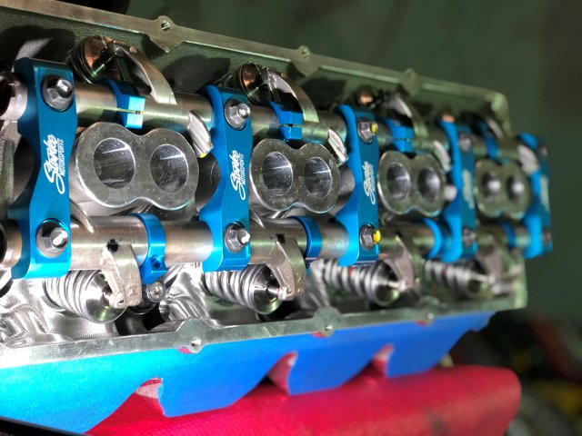

Everything will be perfectly fitted and tuned look at parts so far. This will be the replacement for whipples

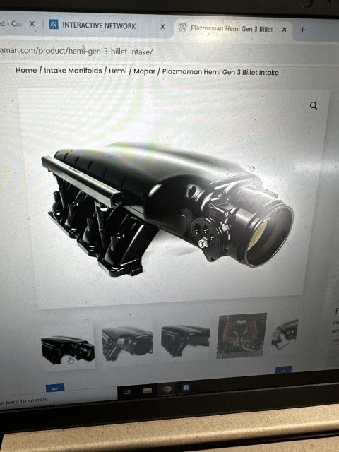

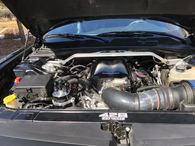

Any pics on that alum. 426 block? I too have a Plazmaman intake. Not cheap but beautiful to look at. Problem we had with it is there is no place for the MAP sensor so you'll need to custom fab a place for that. Also no breather for crankcase ventilation or place to add oil. Had to get new CNC rocker covers with venting and oil access. The stock rubber gaskets/seals are too small and now get some air leaks around the intake runners. Car runs like crap right now. Found fatter rubber seals that will be replacing the stock ones soon.
Also have a Hellcat throttle body which will not fit. Had to CNC a custom adapter plate.
I used it for an N/A application. Prob. not the most efficient use of the thing but just couldn’t help myself.
View attachment 119933 View attachment 119934

I have the full Manton rocker set up with his covers for crank case breather system.

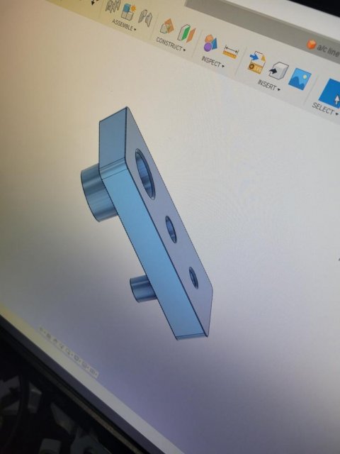

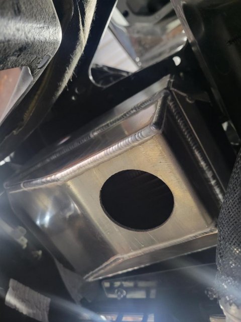

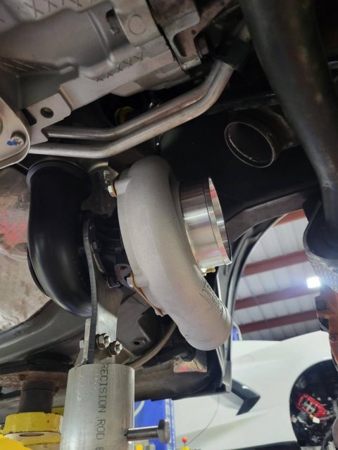

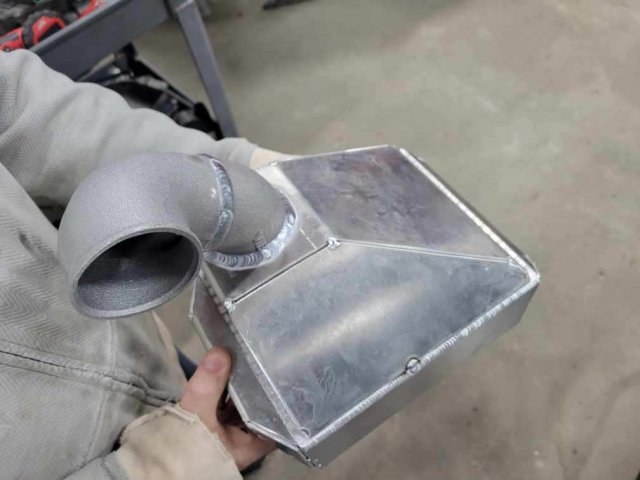

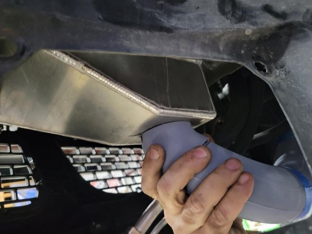

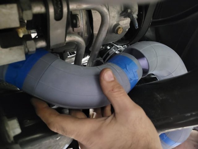

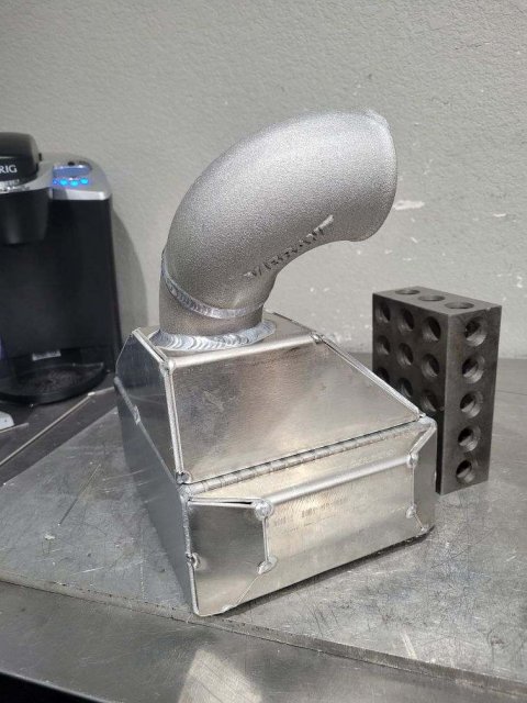

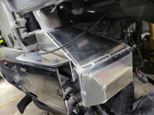

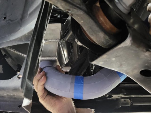

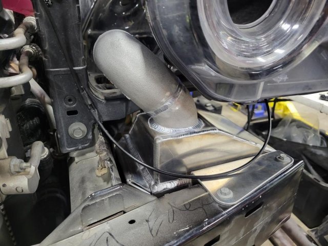

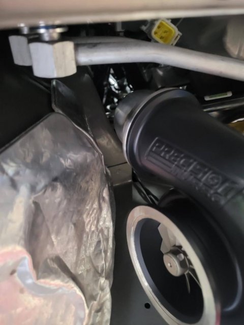

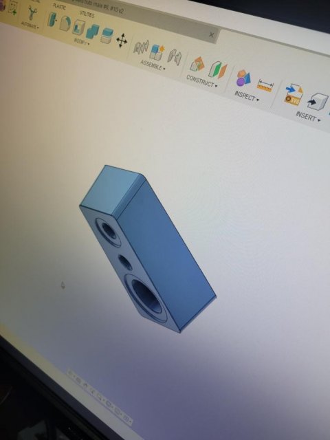

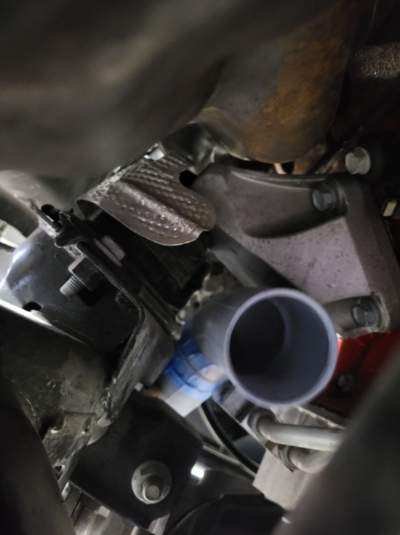

Here is some more updates from Peitz Performance. Making it where a factory chiller on a Redeye will still function Resized_20231102_183340.jpeg Resized_20231102_183346.jpeg Resized_20231102_183356.jpeg Resized_20231102_183408.jpeg Resized_20231101_181643.jpeg Resized_20231101_181855.jpeg Resized_20231101_181848.jpeg
