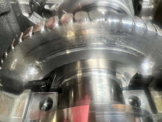

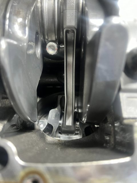

Before I go on to talk about my 2nd 441 stroker, one additional issue was found upon tear down for repair and refresh. One rod was slightly bent. The rods that were in it were Carillo Pro-H selected for being lighter in weight. This is important to note as I move on to the next motor to talk about. I was extremely happy with my 1st 441 motor and how it performed. Based on my experience with 441 #1, I wasn’t expecting any of the failures that occurred this year. Looking back, I made 27+ 7 second passes with it plus countless more 8 second passes over those 20 months. Interestingly, I didn’t start consistently trapping 180+ until I swapped to the new gen 5 Whipple 3.0L and 3.8L blowers with the new Nitrous Outlet intake plates and that’s when things started to become a bit more unreliable with the additional power I had at my disposal.

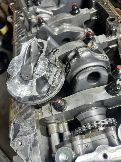

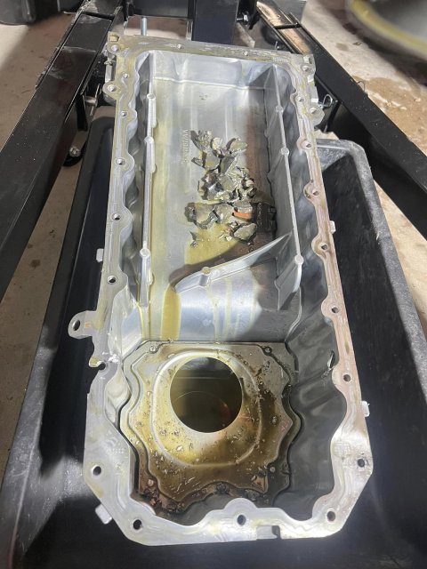

My next motor, 441 #2, lasted just 3 months. Before it decided to let go, I ran 6 seven second passes on it including record reset passes of 7.70 @ 182 with a 1.18 60’ and 7.62 @ 183 with a 1.16 60’. Shortly after those passes, I swapped my HP90 factory style transmission for a TH400 and started testing. Unfortunately, I had issues and mishaps that led to several unintentional over rev scenarios and limiter bouncing scenarios, all while wanting to try and progress as quickly as possible to get back to feeling competitive for TX2K. I ended up kicking a rod and windowing the block on a 400-450 nitrous shot test pass, same shot size I’ve been running on all of my deep 7 second passes prior. Upon tear down and inspection, #1 rod had twisted like a pretzel then broke, #1 piston made contact with the head and valves, and #6 rod was visibly bent as well. Besides that, spark plugs all looked great along with everything else up top, no signs of knock, detonation, or excessive heat. Possible cause for failure? Either too much unintentional RPM or I overpowered the rods or a combination of the two. These were the same model rods I had in the previous motor. Coincidence? Maybe, maybe not, it’s hard to say with such a small sample size and many uncontrolled variables. Still, I didn’t want to try them again knowing I would likely want to keep pushing harder so I decided to try Wiseco Boostline rods next.
349179777_624537609736215_7629101350290267531_n.jpg 350065945_219214927546001_2052441632562638433_n.jpg 349738647_110900195353267_3135588432438554403_n.jpg 349858427_205311329102578_3917155399654548306_n.jpg 349935923_2120865681443011_7229476192889405465_n.jpg 350137471_289373810095196_4441837356504336928_n.jpg 350100460_600057658758567_4262953822791061349_n.jpg

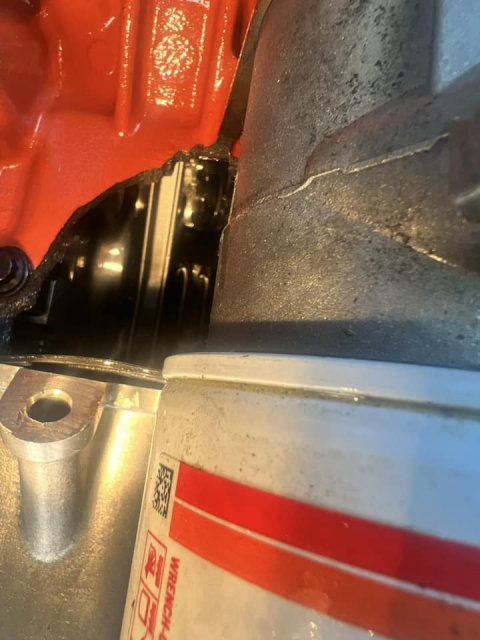

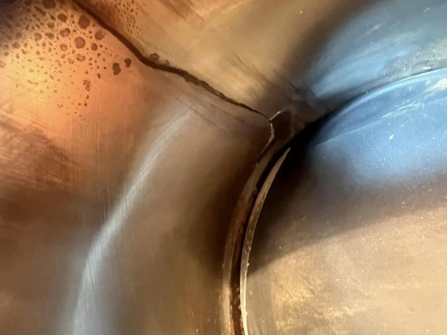

And that brings me to my last motor. A couple weeks ago I posted that I experienced another failure and that was after just over 2 months time. Ok, I’ll admit, at this point it’s getting ridiculously expensive and unsustainable for me. I’m going to have to make major changes if I want to keep racing this car.

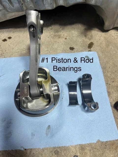

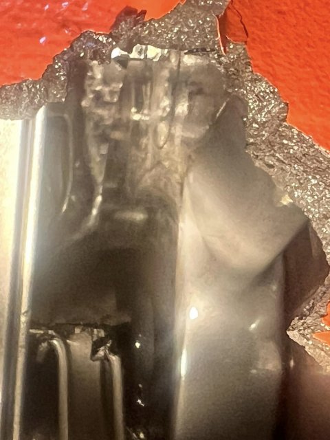

Here are my preliminary findings. Cylinder #7 and #1 cracked through the sleeve and block into a near-by water jacket. #1 rod was bent and twisted pretty bad from hydrolocking. #7 rod was bent in the same manner but not as bad. Eye balling #3 and #5 rods, I can’t tell that they’re bent even though those cylinders had water in them. At first, I wasn’t able to rotate the crank but after removing #1 and #7 rods and pistons, I was able to rotate the Winberg crank freely. I’ll get it checked and hopefully it’s good for reuse. #7 rod bearing shows a pattern that I think can be explained by the hydrolocking and bending rod scenario. Other than that, rod bearings look great. #1 rod bearing looks like a million bucks. Spark plugs all looked great and everything up top didn’t show any signs of distress, detonation, or excessive heat.
So what happened this time? For me to tell a story, we need more detail. Here’s everything else that I’m working with to help explain my conclusions. Keep in mind that some of these observations could just be coincidental. Over the course of those final few days of racing, I made 7 passes spraying 450 – 475 shots of nitrous making around 26.5 psi of boost plus a couple misc. passes with less power. My original 441 motor seemed to have taken it just fine and with the Boostline rods, I was building confidence these rods were going to hold up. The motor overall seemed to be taking it like a champ, that is until it didn’t.
And just like that, when you think everything’s going well, a catastrophic failure hits you to let you know, nothing is guaranteed. Towards the end of that last pass in the final moments of wide open throttle, the only thing that stuck out as being abnormal when comparing previous logs to the last one was a subtle change in knock sensor pattern. This doesn’t mean it was knocking, just that it was picking up a little more noise than normal and this is when I believe #7 cylinder and block cracked. The car felt perfectly normal, fueling was perfect for the whole pass and the only indication that something might be wrong was seeing an opaque white smoke form up behind the car after I let off with my parachute out. After a short time passed, it lessened to where I couldn’t really see it anymore as I continued to slow down. Then as an afterthought I clicked it into neutral and the motor rpm abruptly dropped and died while I was still moving at over 70 mph. In the data log, I could see a big change in o2 sensor patterns on the problem side. This was due to all the steam and water that was hitting it while I was slowing down. There was also a dramatic and distressing change in knock sensor patterns while slowing down indicating that the motor likely experienced some sort of catastrophic failure. Bending rods explain that. After I got the car stopped, I heard something boiling and thought it was my coolant reservoir bubbling over. It turned out to be water in my exhaust still dripping out of the pipe. The motor wouldn’t turn over either, it was completely seized.

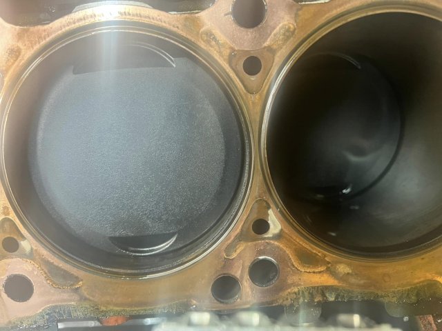

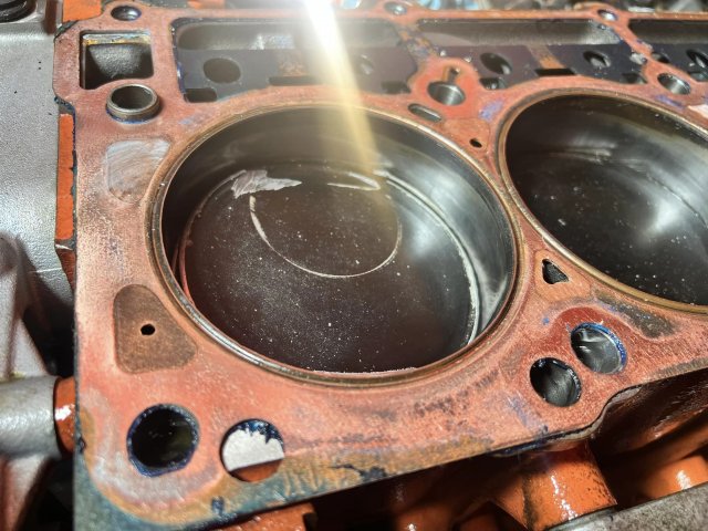

Later when I came home, I scoped every hole. On bank 2, cylinder #2, there was a small amount of water pooled inside. Everything else on that side looked mint. Bank 1 with the cracks had water pooled in #3, #5, and #7. #1 piston was near its topmost position so it would have been hard to see any water in it. The blower intake runners on the problem side showed clear indication of a ton of water and steam that splashed up as high as the intercooler bricks. Besides plugs on the problem side coming out with water on them, they all looked great. My coolant reservoir was empty and my radiator nearly empty when I went to drain it. I also tested the Whipple intercooler bricks for leaks and found no issue with them. All the water came from the engine’s coolant system.
Taking all this in, I believe #7 cracked towards the end of my pass due to being repeatedly subjected to excessive cylinder pressure leading to an eventual stress related block/sleeve failure. After I let off and was decelerating in gear, the motor drew in a ton of water through the new crack that formed filling #7 to the point where it got pushed out of both intake and exhaust valves. Water started filling the rest of the cylinders on that side but since I was aggressively slowing down with parachute out, a lot more of it ended up in #1 causing that rod to bend and twist in a worse way eventually cracking that cylinder wall as the piston seized in the bore.
Some of you might wonder how does that much water get sucked in? Well consider this, each cylinder is like a pump that sucks in and then expels air through 4 strokes consisting of intake, compression, combustion, and exhaust. When you have a new source for the cylinder to draw in something, in this case water through crack, and it’s always open, it’s now going to suck water in every time the piston moves down during intake and combustion strokes then try to push it out during exhaust, and bend rods during compression. The crack however does provide some relief and I believe that’s why #7 rod isn’t bent as badly as #1. #1 is bent bad because all that water had nowhere to go at first during compression strokes. I think I got that all right but if not, perhaps someone can correct me.
