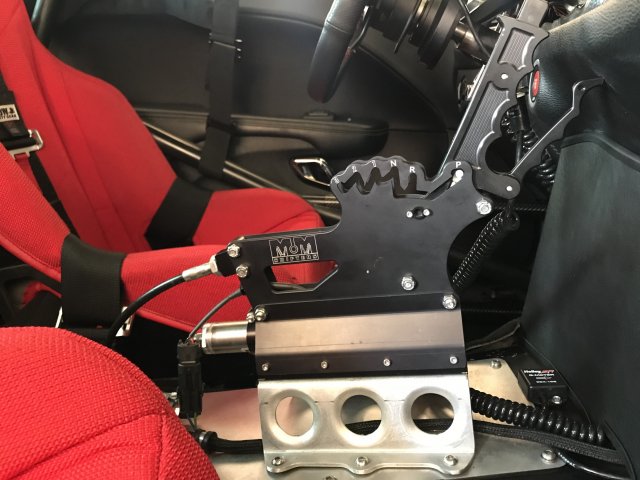

Its been years but i thought you were not supposed to go into neutral in a 400, can overspin the trans and turn that into a grenade.
Again, it’s been years and I'm sure someone possibly came up with a solution by now. I'd double check with your trans guy.
That’s correct if you have a standard valve body. But there are alternate valve bodies out there that have a “clean” neutral built in. Clean neutral reverse pattern valve bodies allow you to put it into neutral without causing it to overspin. It requires a shifter designed for this style of valve body. The shift pattern goes like this.
Park - Normal Neutral/Reverse - 1 - 2 - 3 - Clean Neutral
@Boris
A picture of what the shifter looks like for a reverse pattern safe neutral valve body.
3,288
10,443
These special race T400’s are not your old Chevy turbo hydromatic. Many of the clean neutral 400’s actually go into reverse by activating the transbrake while in the reverse position on the shifter. If you don’t do that it will damage the trans. Also you never start your burnout in first gear and shift to second. Second gear start only with one of these things. I have a completely different setup in mine. I have the valve body with no clean neutral. When I let off the gas in high gear, it immediately starts freewheeling and the rpm goes to idle. These things have about as much in common with that old factory 400 as the space shuttle. Mine… A3AFE9BE-8DEC-4B1C-AAE4-68FEB44E31C5.jpeg
Figured there would be something by now.
Sold all my race car shit back in 08/09
My 400 wasn't stock chevy but was told by my trans guy not to shift into neutral.

We have clean neutral at top as well and I have not gotten used to it. It just sounds like the motor will blow up each time going from 180+ into neutral. I have to wap the throttle as few times to get most of the gas out of the cylinders.
