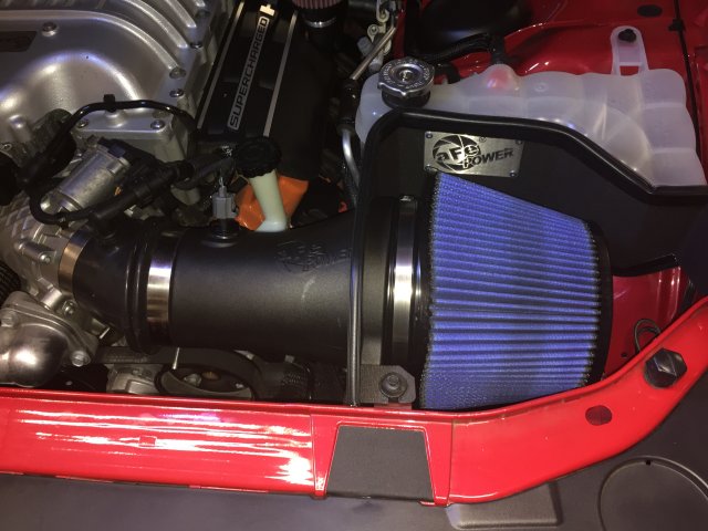

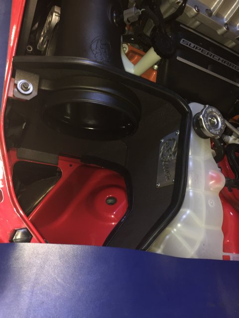

I installed an aFe CAI last night. It comes with a metallic heat shield which looks to close off the intake area fairly well. I’m sure the metal will conduct some heat through at normal speeds but at higher speeds it should pull more exterior air in.
I mainly bought it to hear the SC better. ;) 15AA0179-8D5D-400C-A2F0-F8B2E4983366.jpeg ED58EBC2-E9FE-408A-9CFD-13686C168744.jpeg

Looks like they changed the piece that goes from the throttle body to the intake tube with one that can flex some. Looking on their site they also show a piece that doesn't have the according style ribs. I'm curious if that piece could replace the stock one?
It looks like a nice intake overall. I would like to test one at the track if I ever get a chance

Looks like they changed the piece that goes from the throttle body to the intake tube with one that can flex some. Looking on their site the also show a piece that doesn't have the according style ribs. I'm curious if that piece could replace the stock one?
It’s a very flexible silicone boot that attaches to the throttle body. I’ll be keeping an eye on my intake air temps when I get it out. First I have to drop the F%$*ing belly pan to retrieve a screw I dropped last night…
