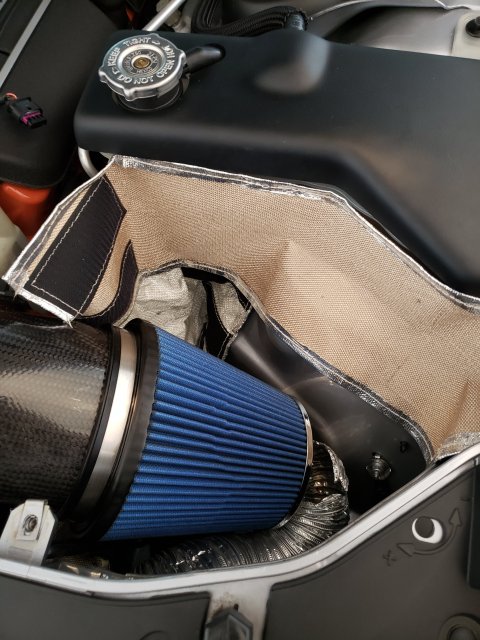

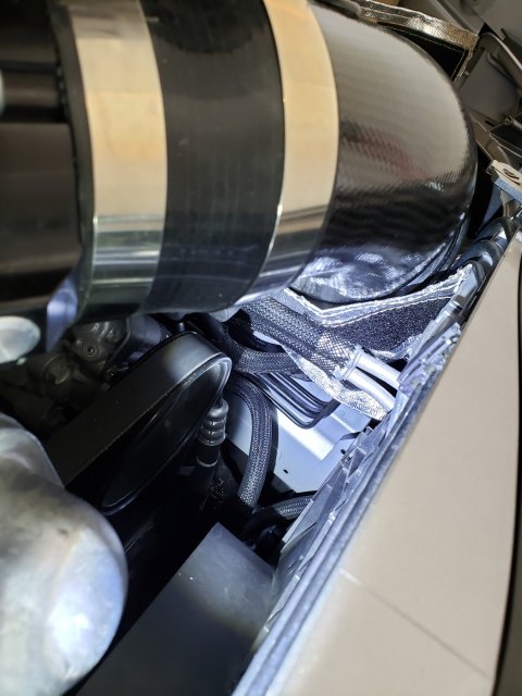

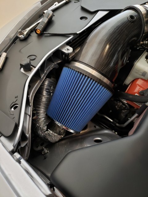

I got mine installed and played around with the 2 heat shields I have. One shields goes under the intake to the coolant tank. The other is blocking the coolant tank. My thoughts are getting some ceramic fiber insulation board to block off coolant tank and the area between the tank and filter. I will also use the heat shields
My tube I run to the airbox (stock charger is really small) was long enough to bend in front of the filter

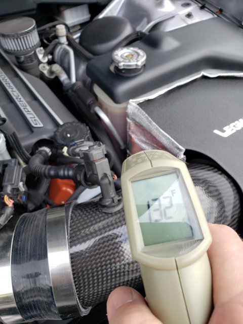

went out and drove the car. Temp gun towards the back on the outside of heatshield was reading 140 degrees. Pointing it into the air box it was showing 85. When the fan kicked on it just heated everything up. It will need to be sealed towards the front and between the intake and lid
If the fan spun the other way it would help meaning the blades would have to go the other way to push the air towards the passenger side. I don't notice as much heat being blown towards the passenger side. In testing I'm surprised the engineers did pick up on that. Having a shield to block the hot air blowing on the intake would be another fix

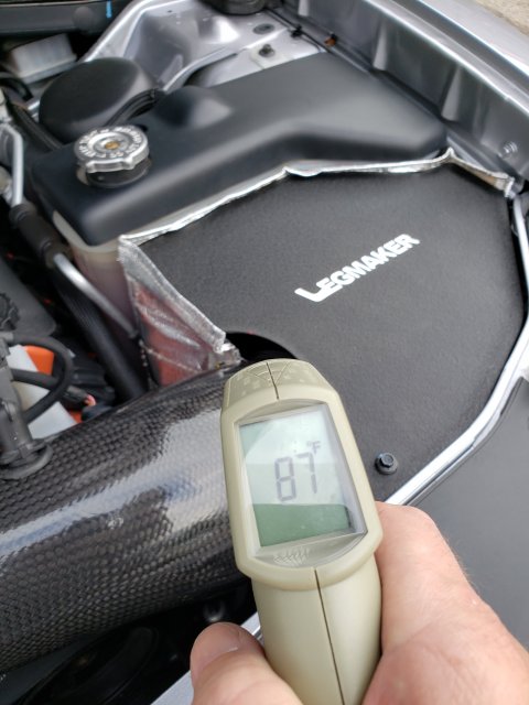

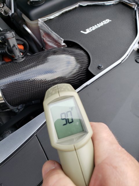

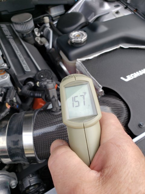

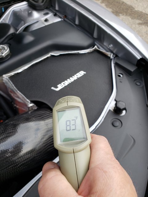

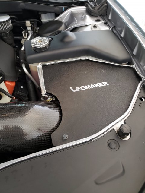

Drove to GR last night and popped the hood after 30 minutes of highway and street driving and took some readings.
3rd pic shows 87 and the dot appears to be on the lid. It was showing around 85 inside the box but moved when I took the pic. All the reading I got inside the box were in the 80's
