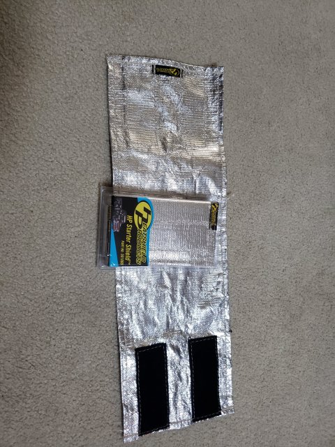

I was playing around with ways of keeping the intake tube cooler on my Daytona. One idea I had was to wrap it in heat reflective material. I bought one made for a starter which would be used to keep header heat off of it.
My thought on this project was to use something stiff to block the engine and coolant tank from the intake filter and attach the reflective material to it. This one I bought is 7" wide and 21" long which would block the engine and the coolant tank. They make different sizes and may be cheaper to buy a big piece and cut it up to do a few
I bought a legmaker and when I get it I'm going to see what I can come up with. The shield is about $40 but like I said there are different ones out there and a big piece may be more cost effective

Keep in mind the LMI is carbon fiber and not plastic. I wrapped my Hellcat CAI with a similar product noted above but the LMI performs better and sounds so much better.
#50
I have rolls of that stuff for insulating garage doors with. Amazon comes with 2 sided tape. Large rolls and smaller rolls. Can use foil tape to tape the sides. Works great. Cheap
Not wrapping the intake tube. Using the reflective material on the box go around it

Keep me in mind brother. Think my material will work?? Very flexable and shiny,, mention, cheap.
