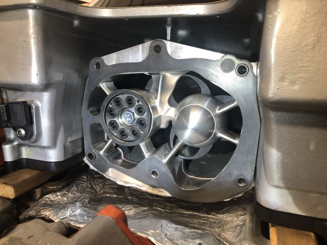

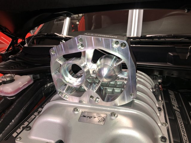

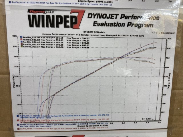

I've contemplated doing this as well. Did you remove the front bearing plate and do any work there?
Starting and ending grit?
Did you consider an smoother finish? (Polished)
I used a FAS plate, ruined my original blower the first installation because the bearing bores where too tight. Gained a Dyno proven 50 hp with it though on the second blower, luckily I had a new spare blower in a crate on hand. This dyno graph is before plate and after plate. I also port matched image.jpg the stock snout to the plate and added a fast man true 95 mm throttlebody.
AD11CB0F-CB94-4D06-B0A0-D1F5CE373BD3.jpeg BB56B9BD-54BD-4DAC-9CAF-6FAD7086C7D5.jpeg
