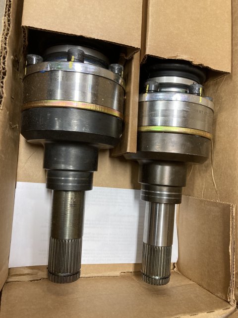

In prying on the axles what you are trying to achieve is pop these spring clips from the slot they are in inside the female spline, even pressure on both sides of the hub makes them come out easier by pulling straight not pushing them to one side. See the clips on the ends of the spline in this picture?

yes sir, I see exactly what you guys are talking about now. Makes perfect sense !!
I can’t believe they come out so easily. I guess as long as everything downstream from the axles is torqued properly they won’t go anywhere.
I am assuming the brake caliper, rotor and axle nut will have to be removed in order to be able to get the axles out. That a correct assumption?
