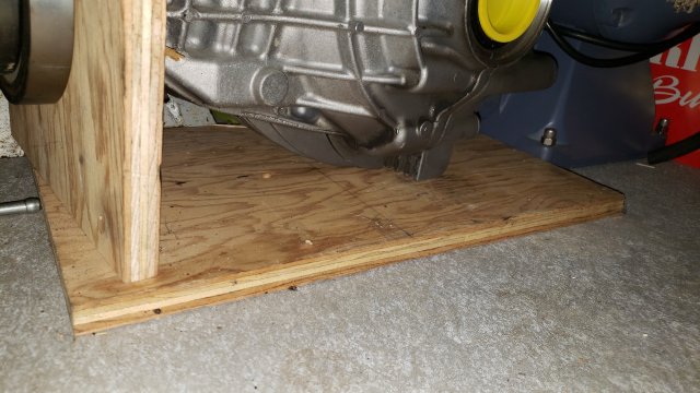

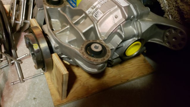

I was supposed to get you a picture of mine, will post in a minute after this.
I made mine from 3/4" plywood. The front was a u-shaped/yoke thing that went up from a flat section of the plywood and "grabbed" the front input shaft/flange area. In the pictures, the front is unscrewed from the baseplate, but it was attached when I was actually using it.
I also drilled the lifting foot of my floor jack and attached the plywood base to the lifting foot so I couldn't slip/tip.
Pictures coming next.

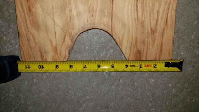

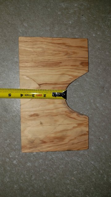

Diameter of the cutout is 3", flaired out to about 45deg
If you happen to have 5/8" plywood, it will work better, the 3/4" is tight on the flange.
BULL, you are a good man sir!! Thank you for going through the trouble to post the pics.
many thanks !!

i had that very same thought. Id like to avoid buying a transmission jack for this job.
16,880
52,878
#53
I bought one (addon for my Napa floor jack).
Biggest PITA, useless, cumbersome thing I've ever paid money for...
As long as you secure the jig to your floor jack so it won't slip/tip, this really is a pretty easy task.
If anything is challenging it's the access to the bolts and removing the axles, but even that wasn't hard.
It took me the better part of a day to do, but only because I kept stopping to clean stuff (that wasn't really dirty to begin with).
OCD can be a bitch sometimes.
