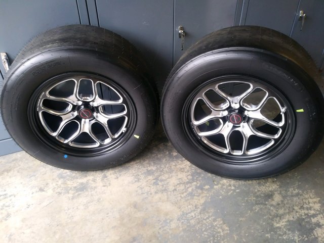

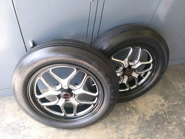

First issue is wheels and tires. One set to go fast and one set to drive back and forth and race locally. All 4 Front tires and wheels from the Frostbite Redeye Narrow Body will be re used. I am 90% sure I am going to go with the Pro Mod look and use the rear Win Lite narrow body wheels on this car. So the tires will be centered 1-3/16" farther inward than normal, but should still fit without rubbing.
These are the Billet Specialties Win Lite Drag Pack 18X5 and 17X10 wheels with Hoosier Drag Tires, 28X4.5-18 front and the Drag Bracket Radial in a 28/10.5 R17. I could save 2 pounds by going to a nearly identical 17" front setup since this car has Scat Pack 14.2" front brakes. But I think the shorter sidewall of the 18" tire will handle better. So this setup gets used as is since it is all brand new and paid for. 0404201400.jpg 0407201547a.jpg

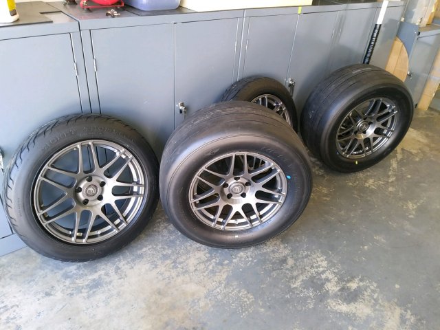

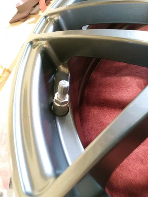

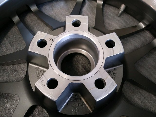

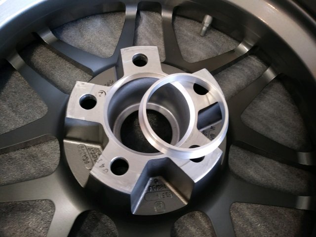

OK, the Street Wheel and tire setup will need changes. I like the front Forgestrar F14 18X5 Drag Pack wheel with the Mickey Thompson Sportsman SR tire a lot. It drove really well on the previous RedEye. Many times I actually forgot I was on a skinny. I run the tires at 75 PSI cold. With the negative offset I bet it will look great on the Wide Body and it ended up driving better than I expected.
The Rear Drag Pack 17X10 has to go. That +30 offset is a deal breaker for the new car. I have looked into other wheels, which would force a new front wheel and I am just ordered new rear wheels. Forgestar F14 18X11 Super Deep Concave 0mm offset Gloss Gunmetal to match the front. I went with 18's because you CAN'T get a 17" F14 in the correct wide body offset and surprisingly there are more tire choices in the 18". I can run the 305/45R18 MT ET STREET R (stretched, my first choice) or the Hoosier P325/45R18 DOT Drag Radial tire and if I wanted to chance a non DOT tire they have the new Hoosier Drag Bracket Radials that I will be running on the Light Weight Race setup in the 28/10.5 R18 and 2 new sizes coming soon 29.5/10.5 R18 and 29.5/11.5 R18, all radial slicks. 0414201608.jpg 0312201605.jpg 0312201605a.jpg F14 HUB RING.jpg F14 HUB RING INSTALLED.jpg DSCN2936.JPG

Weight reduction plans are the same as the Frosbite car.
Wheels and tires. Shockingly the Win Lites / Hoosiers are 65 pounds lighter for the set. All rotating weight.

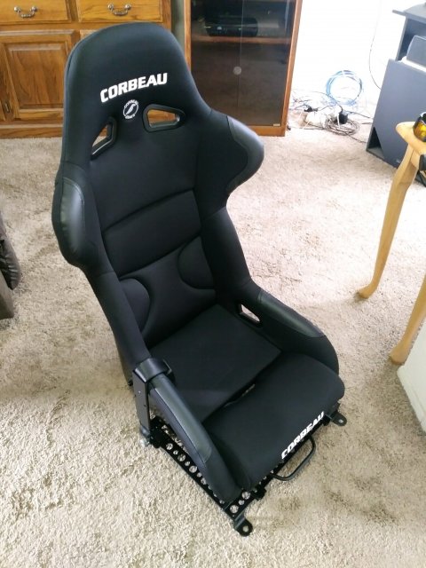

Corbeau FX1 Pro seat, will only be used when car is set on Kill (along with the Win Lites / Hoosiers).

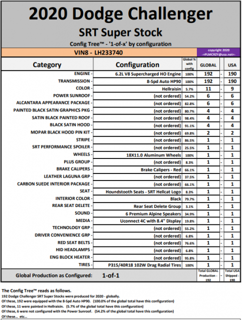

2020 SRT Super Stock Production numbers.........

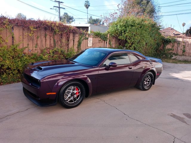

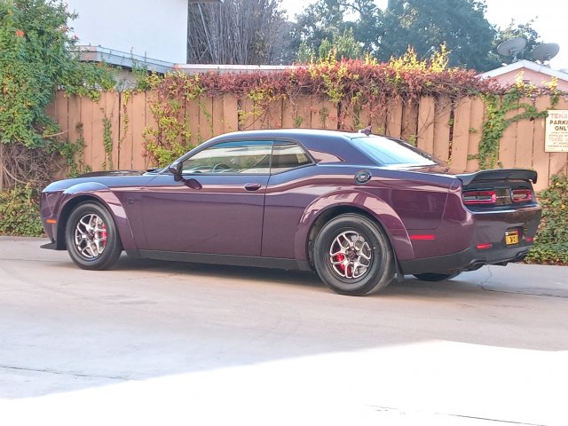

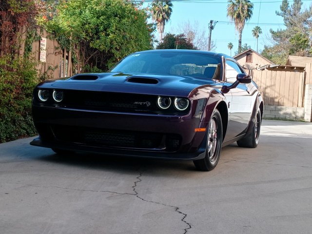

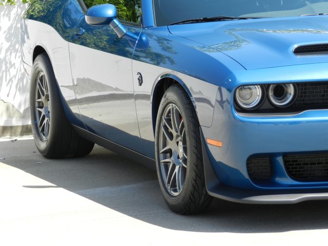

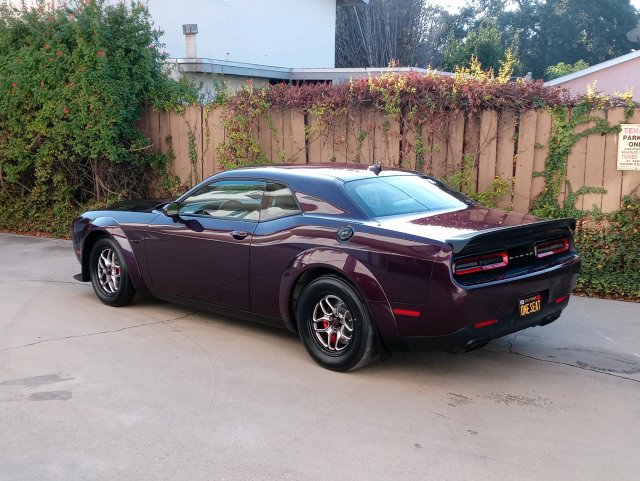

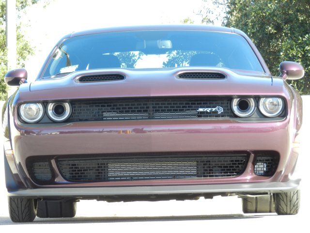

I was able to snap some pics with the Win Lites / Hoosiers on the car today. This is narrow body wheel on a wide body. I already had everything set up and paid for from my Frostbite car and decided to just run it. I think it kind of looks cool in the respect that now the front and back are sunk in a similar amount VS just the front being that way.......
. 0103210916_HDR.jpg 0103210916a_HDR.jpg 0103210917.jpg 0103210917_HDR.jpg 0103210918_HDR.jpg

Thread Starter #14

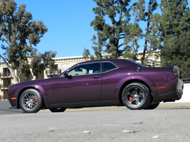

I was kind of miffed because the Press Vehicle is shown with the SRT Performance Spoiler and it is not standard. Still a $995 option. I did not order it on the car. I will get it over the counter and install myself. I also may have the hood wrapped black one day. On this HellRaisin dark purple I think the black hood would look great.

What are those wheels? SS is supposed to be Demon 18’s...
That is just the animated picture off the Dodge Build it web page that I grabbed to show what color I ordered. That is just a standard Hellcat RedEye Wide Body. I will replace with pics of my actual car when I get it.

How do those Hoosier front runners compare to the M&H Racemasters weight wise?
They are 11.6 pounds. VS 16.4 pounds. They are paper thin. Sidewall is not going to take much abuse. I have driven 12 miles to Irwindale and back on them once but I did all city (mostly neighborhoods) and was very careful. Not this set, the ones on my Demon.
