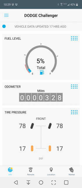

So, last Saturday when I was hot lapping making passes in the middle of the Red List Competition I received a Vehicle Report VIA Guardian. What are the odds of this happening? Do you think Dodge keeps a record of this???? Gulp !
7,313
19,175
Big Brother has black listed that cars warranty lol

That is great, Ron. No problem, looks like you may have been just low on gas going to evening services. Just a bit of air pressures out of balance on a new car is all.

78 PSI in fronts!!!

Paul, that is the Mickey Thompson Sportsman SR 28X6.00R18LT. They are F rated and good for 95 PSI. NOTE: This is the ONLY tire in that brand/style that has the F rating. I actually think the TPMS will read quite a bit higher maybe all the way up to 95 psi.
The car was running on my Street Setup and that is how I run them on the street. The car drives really well on that tire. Many times I forget I am on a Skinny.
The only problem when racing on them is they skid real easy. So when driving out of the burnout towards the starting line many times the front lock up when I get on the brakes. It's no big deal really but it is weird and I dislike it.

I run the same tire upfront now. I previously ran the M&H Front runner but changed after talking to a Mickey Thompson rep at Summit Racing in Georgia, having radials front and rear. FYI: I called MT technical support and they recommended 65 psi for our cars.

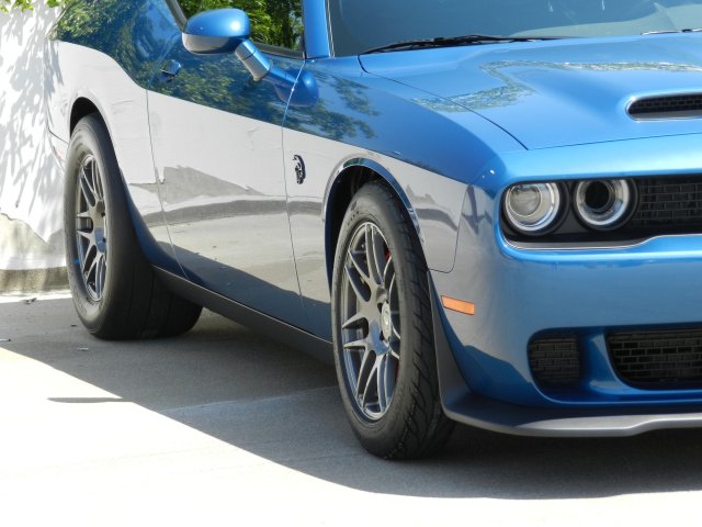

@Viper
The F14's on the rear of the Frostbite car were 17X10 +30 offset. With a 315/50R17 and yes you need max tub mods to make them fit.

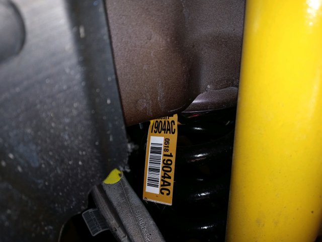

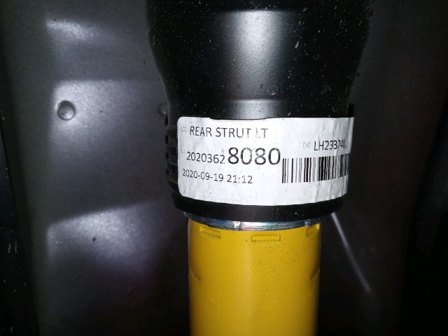

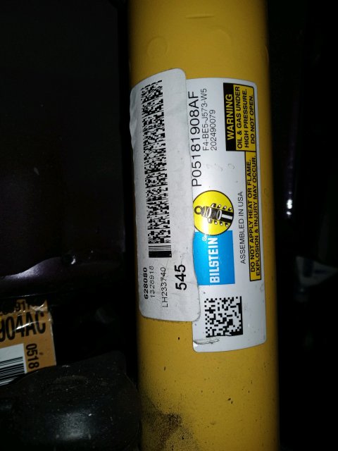

OK, so I was getting the car ready for Houston and changing out the Wheels & Tires and I remembered to take these pics for you guys.
I also verified that HPTuners added the support for the channels I want to Data Log. All of them work now.
7,313
19,175
I'm not up on the part numbers, is that a Demon shock/spring, Hellcat, or something specific to the SS?
