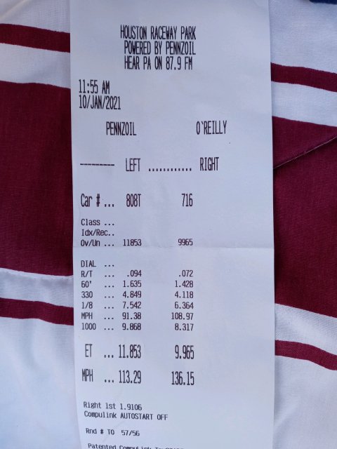

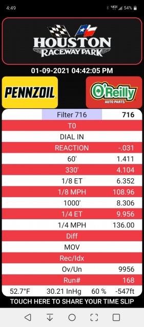

I’m dying over here. Let’s see those times!
Sorry, it has been a long day. The car started out having the Hiccup Blues. So, no Joy with the times in the 10. Oh's......10.09, 10.08, 10.07 and 10.09, but a couple were at 137 mph. So the MPH was a personal best by far, but the ET's were disappointing. So, I went for it and used the HPTuners program to reset the PCM Adaptives. Interestingly I did not have the option to reset the TCM Adaptives which I wanted to do. I will have to email them on Monday and see if they can add it.
After I reset the Adaptives the car took one pass to learn and that was a 10.07 @ 135 and then it ran a 9.96 @ 136.
It did start to hiccup again later and I reset the Adaptives again. It did work and I did a best of 9.95 @ 136. I made 17 passes and had the mentioned 9.95 and 9.96 and also a 9.97 and 9.98 and 2 10.00's.
The car hauls ass when it makes all the shifts and does not hiccup. But it had learned the heavier wheel and tires setup in positive DA and then came out here with the much lighter Wheels and Tires and shorter rear tire and great DA and then all of a sudden it is over revving before it can complete the shifts. Resetting the Adaptives helped but did not last for some reason.

Nice Ron and thanks for sharing your experiences with these monsters..

Great times Ron I bet your over the moon,what was the da?

Congrats on the 9's!!
The DA was -1300 when the first runs were made. But the times were not good because of the hiccups. The power the car was making with that low DA was causing the car to not be able to complete the shifts in time. When it ran the 9.95 the DA was -547 feet per the track app. Other runs the DA got up to about -490 or so. But all the first runs were in Neg 1300 to Neg 1100 or so.
OK so some TECH. I was told by someone that is VERY smart that the reason resetting the PCM Adaptives would cure the Hiccups is because resetting the Adaptives will cause the engine to make LESS power on the initial runs after the reset. That is why it wore off, so to speak. As the engine fine tuned it's self for ideal performance it accelerated faster and the Hiccups returned.
