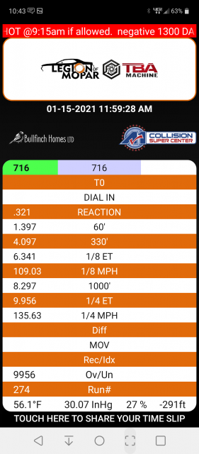

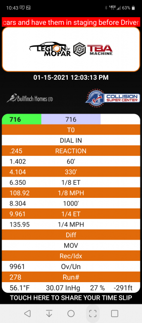

Here is an example. The car put up 2 good passes back to back and did not hiccup. If you look at the data at the bottom I am thinking the Power Chiller just came on. Also the Power Chiller will affect the 60 foot. So the car was making more power but did not hiccup. I have a lot more to learn. I really want to have the car on point when the DA is -1300 feet. It was kind of expected with the hiccups that the car would do better near zero DA.

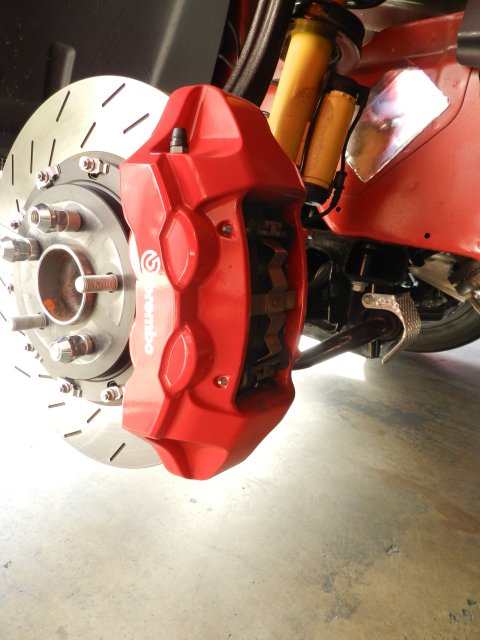

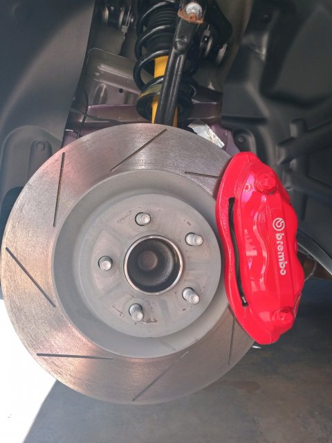

The Demon, SS, Scat Pack and 2008-2014 SRT all use the same size 4 piston front brakes. But the Demon uses a lightweight floating rotor/hat and it has an all aluminum billet caliper. The Scat Pack caliper is forged aluminum and has this large steel backing plate that is cad plated and on the SS it is painted Red along with the caliper.
SS
DEMON

Interesting

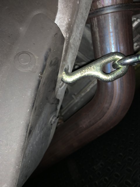

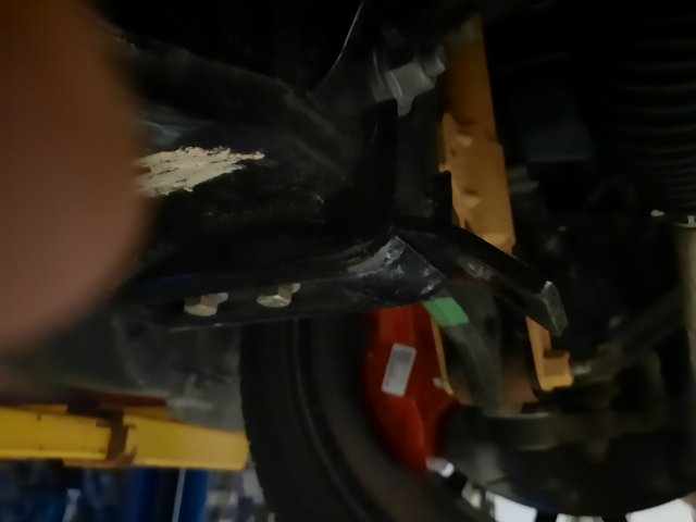

Project for the day........Since I will no longer be able to use my original tie down points.
These bolt on the front side of the LCA pivot bolt and hang straight down similar to the ZL-Design. I may not go with these if I proceed to install them and do not like the way they function. Otherwise I will put a compact forged hook into the LCA and the hook goes IN the slot and downward and out the round hole on the bottom. Someday I will post a pic of this. I have used this method on my Friends Demon recently when I had it.

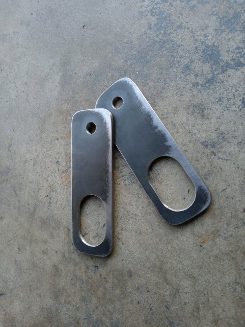

made these up for my car. assuming this pocket is still there on later models, 2 by 1/4 flat steel slides in ,center punch through both holes then drill 3/8 holes an weld 2 nuts on top side ,bend the ends an make your holes for hooks, slide in pockets an install bolts with washers.

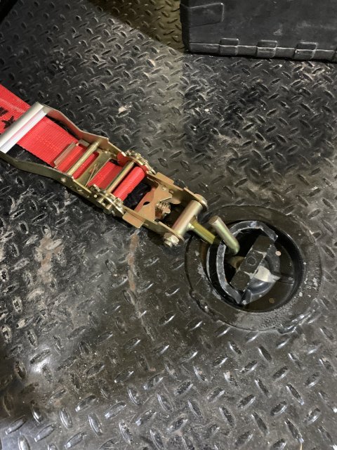

I use these straps to tie the front down on my challenger, they use the factory tow points. 4C238FEB-1B3B-4B68-8153-8EA5BBCE3B97.jpeg 3DD60F94-CED3-4AEF-99CA-211ECA69B33C.jpeg

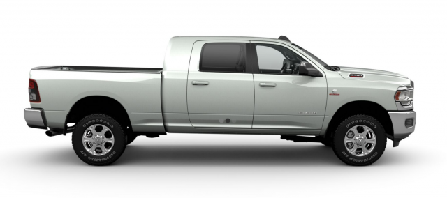

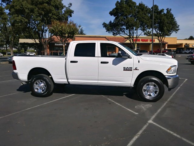

LETS TALK TOW TRUCKS : REVIEW
ALL 3 Brands are amazing. But if I am not backed into a corner it is going to be a RAM 100%.
What about all this craziness with used vehicles. I paid $45,200 for my Current truck that I just sold, and I got $44,000 for it. I will admit I got a great deal on that Truck, but still............
The Ram 3500 4X4 Tradesman 6.7 HO AISIN that I just sold was amazing. The power was intoxicating at times. If you happened to be right at the good point in the power band and you laid into it, even with the loaded Trailer, it was mind blowing. Torque of 930 will do that.

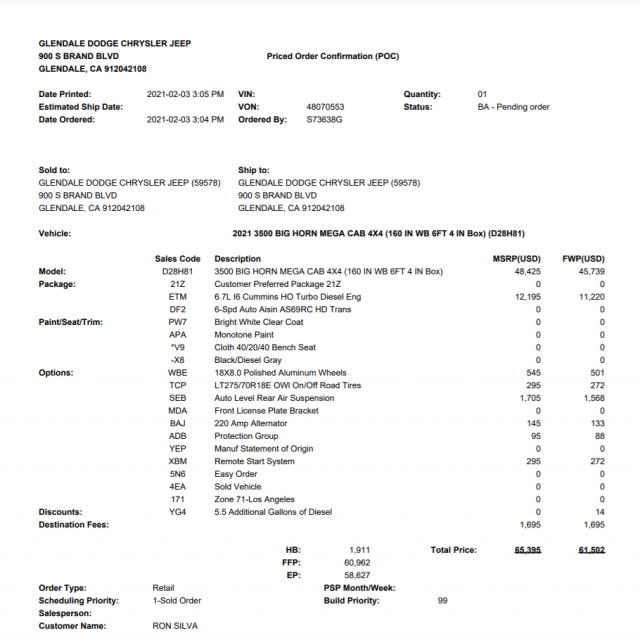

Here are the reasons I made this move. I tested the water and did the math and I found out I could get a good selling price and then order exactly what I wanted and have a 3 year newer truck that does not need new tires. I am going to be out of pocket a total of $24,000 or less and that is not including any applicable rebates.
#1 Was the old Truck would pull substantially harder with my foot on the gas pedal than it would if it was in cruise control. I tested this many times and in 100 different conditions so it is not something I was imagining. So this forced me to either lock out 6th gear, let the truck downshift all the time, OR use my foot (not use cruise control). I would much prefer to use the cruise control on long trips : New Truck, 1075 foot pounds and 420 HP, AND 373 gears (vs 3.42's). I am hoping it will run cruise control more of the time.
#2 The new Truck has the Electronic Shift-On-The-Fly Transfer Case. Old Truck was manual and I never put it in 4X4 because I was afraid of getting goofed up on the shift. Stupid I know. I am sure if I really needed it, I would have gotten it done, but now I never have to worry. This Truck, it is standard with the Big Horn, which leads me to the third item.......
#3 I wanted to have more room to sleep in the Truck and so I wanted to get back into a Mega Cab. You cannot get a Mega Cab in a Tradesman so I had to move up to a Big Horn. I like to sleep in the Truck to save money but more importantly it's way more convenient when traveling and I am with the Super Stock / Cargo, so I know it is safe from Thieves etc. So, with the Crew Cab I made a really good bed for myself in the back seat area but I literally just lacked a few inches from stretching out the way I wanted to, diagonally. The Mega Cab will EASILY fix this.
#4 Ride Quality. I ordered the Automatic-Level Rear Air Suspension. The more I read about this the more I liked it. The Design and concepts are right on point as far as I am concerned. That and 10" longer wheelbase should make a nice improvement in ride quality.
I went for nicer rims and some better tires. I also added the remote start system because it can be used as a cooldown timer.
OLD TRUCK:
NEW TRUCK: 2021 ram image.png CROP POC.png
