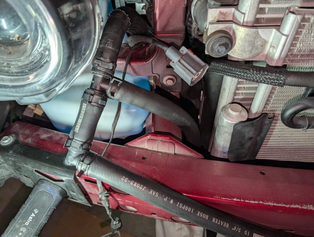

I don't have a tank. But here's how I did mine:
Code:
HX and IC Brick are XOR, stock HX flow direction:
                           /--C--> IC_Brick -C-> bypass hose -C-\
SC_hot -F-> pump -C-> 3-way                                     T -F-> SC_cold
                           \-C-F-> HX ------------C-------------/
lines with an "F" in them are factory
lines with a "C" in them are custom

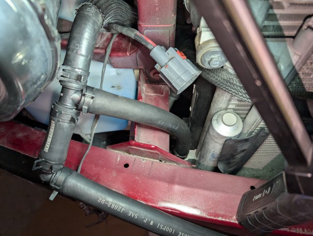

T on passenger side:
- factory hose originally from SC cold hardline to HX outlet is relocated to come off the T
- new short line from HX outlet to T
- new bypass line from T across top of bumper to 3-way valve on driver side (T to short piece to 90 to bypass line across)
Bypass (chilled) flow goes through 90 then straight through T, non-bypass (HX) flow goes through 90 bend in T

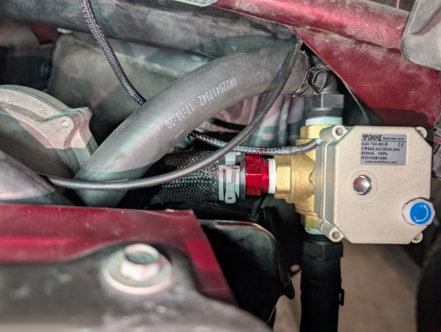

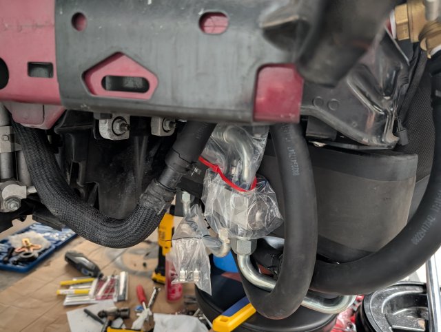

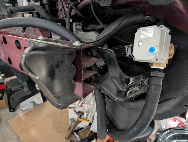

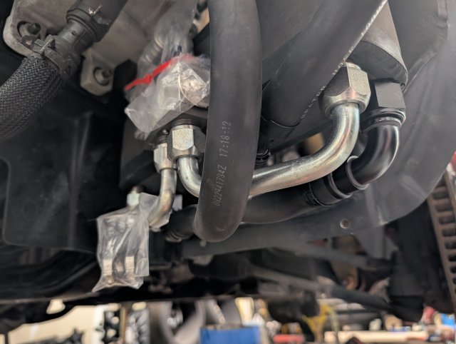

Driver side: 3-way valve comes straight off pump outlet:

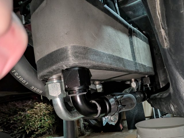

Driver side: 3-way bottom outlet goes down then through a 180 bend into the IC Chiller brick outer-most connector:
Driver side: 3-way top outlet goes down with a 90 and small new hose, joined to the factory hose into the factory HX inlet:
You can of course swap your 3-way outlets, or route differently. I wanted to minimize how much of the factory lines needed changing, and I especially wanted to preserve the factory lines on the hot side to the pump inlet.
I have mine set so if the power fails to the 3-way it defaults to use the factory HX--so worst case I at least get ambient cooling to the SC. Gotta throw switches to enable it all--both the bypass switch and the cabin AC. With this setup, user error could result in HX bypassed, but AC not turned on, thus no SC cooling. I plan to remedy that later on with a CAN-bus enabled controller board.
