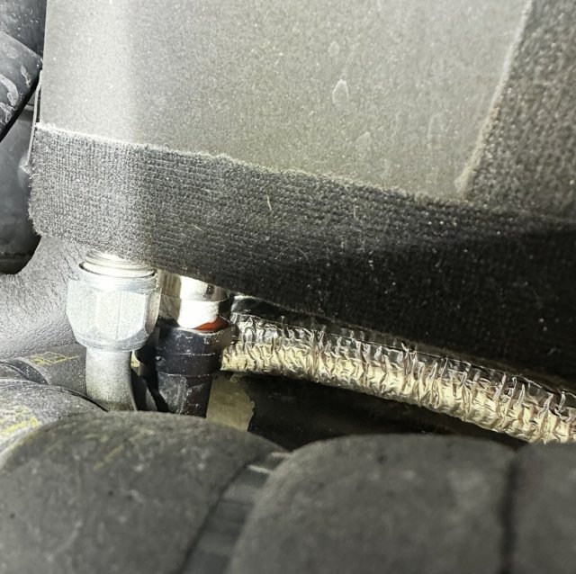

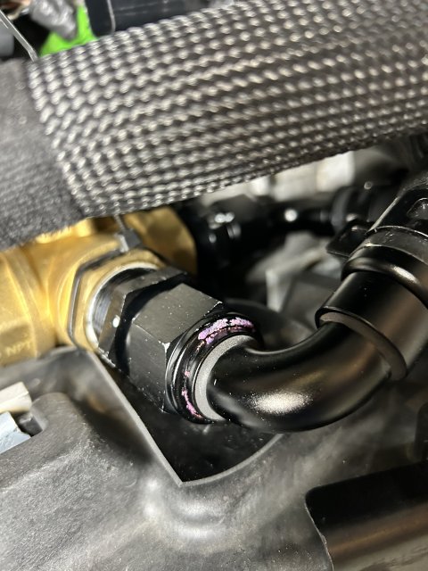

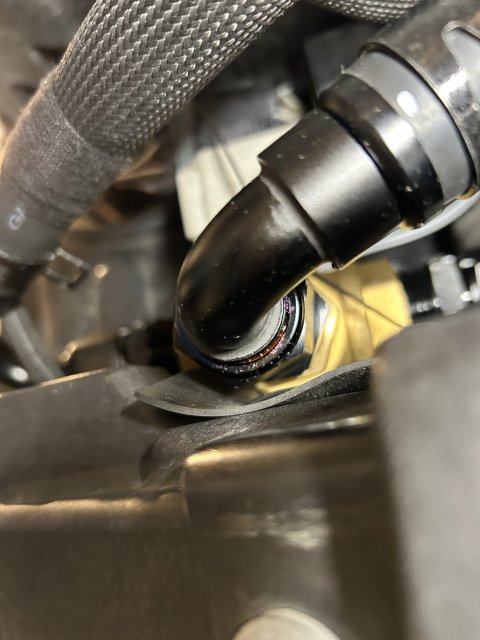

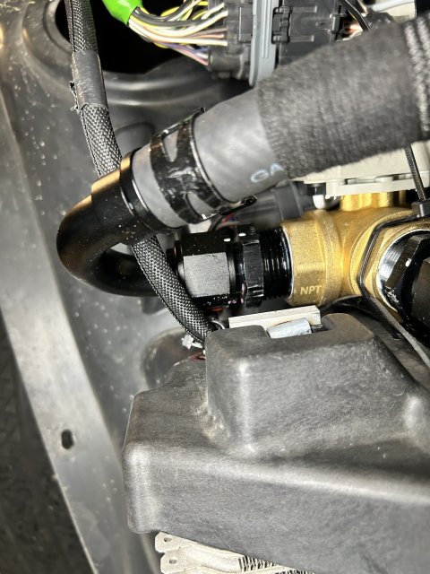

Dang it. Too loose? Hand tight then snugged tight using two 8" wrenches. Or just bad ones from Amazon?

Hand snug then 1/4 turn. Both mating surfaces need to be perfectly clean.
View attachment 173667 View attachment 173668 View attachment 173669 View attachment 173670
AN fittings are a lot more temperamental than most people think. You are trying to get it to seal with just metal on metal. Always make sure the surfaces are clean and spread a little new motor oil on the flare before assembling. It's good to start out snugging them up and applying some force. If there is a leak, you can go tighter. For -12AN, you can actually go to 40 ft/lbs. To do this accurately, use a torque wrench with a crow's foot clocked at 90 degrees to the wrench handle. (There are tutorials for this.) I have had to go to 40 to get something to stop leaking before.
That being said, all AN fittings are not created equal. I have used Amazon ones that would NEVER form a leak proof seal. I like RaceFlux for quality without an insane price. I have never had an issue with one of their fittings. Plus, they do some clever stuff here and there. Like, their caps have the flare but include an O-ring for added backup. Good luck man!
