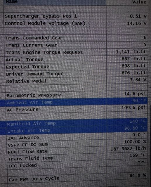

I am seeing IC coolant temps of high 50s with ambient being between 88 and 98. So, the coolant is 35-40 degrees cooler than ambient. Keep in mind there would be a much larger difference between IC Coolant temps before and after the chiller; I am looking an ambient air. It seems to see nearly 40 degrees in difference whether it is 85 or 95 degrees outside. When I go to chiller only mode (turning off all cabin AC), it is another 10 to 15 degrees colder. So, this weekend, with 90 degree weather (very humid in Central FL), I saw 46 IC coolant temps.
The lines are all very icy. I am also using the aux tank. When I installed and first tested this in the winter, I did see IC coolant temps of 30 degrees in chiller only mode. But, it was 60 degrees outside. This thing definitely works better than stock, but it was A LOT of work. I had to sort and chase a lot of issued and leaks. It seems dialed now.

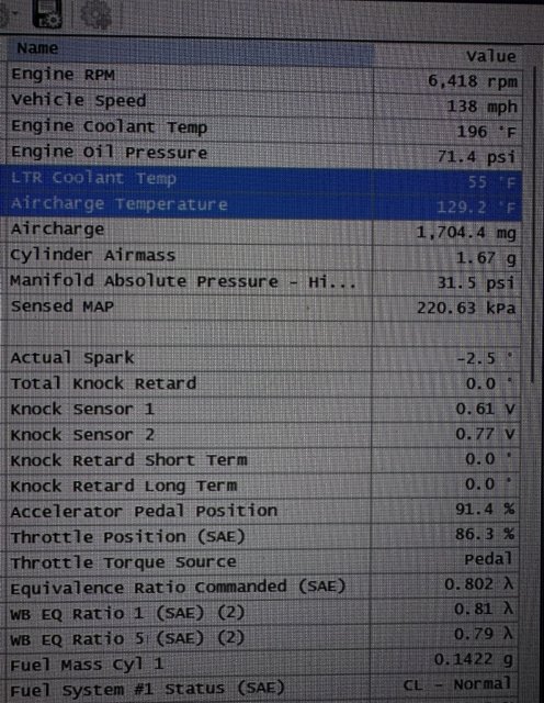

Mine never goes above 55 F at the top of the track on a 90 degree day, and that’s when it’s around 30 after the burnout. Also in soggy FL

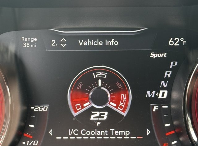

Chilly day : IMG_3541.jpeg

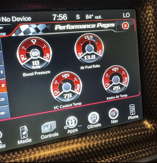

Hmmm, yeah, I don't know. Mine was also professionally charged the first time (before I had a freon leak), and it performed the same. I broke down and bought gauges so that I could find the problem, test it, etc. I charged it up with R134. There is no R123yf left. In theory, R134 should be even colder. I weighed the freon in. I am OCD, so trust me, it is perfect. We have the same amount of freon essentially, if you are at 28.5 oz.
You are running a challenger I see. Do you have the stock HX at all? Maybe mine is sapping some cooling when it is in bypass? It's not flowing, but the fluids can touch. I have the ability to do all HX or all chiller. Also, look at the data you posted from the performance pages screen shot. How is your IC coolant at 78 and your air intake temp is 26? How would air intake temp ever be 26? Nitrous? It would seem impossible to have IAT below IC coolant temp...

The older challengers the gauge is swapped - that’s actually IC coolant temp. I have the big main heat exhanger, got rid of the small one where the chiller goes. My chiller is inline all the time, so even bypassed to HX it has to run through the chiller first. The way I have it plumbed is so that there’s as little chance as possible for it to back feed into the HX. I also do not use an AUX tank. More volume = more time chilling. All of my lines are insulated. Rubber and aluminum.

Kudos to @16GoManGoHC2 if he can tell me how much boost I was pushing there
