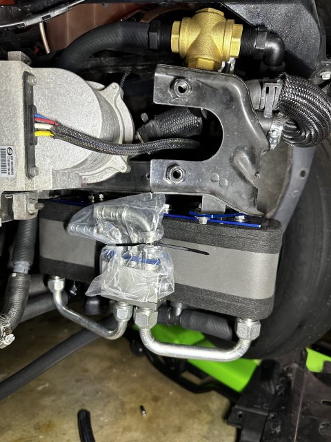

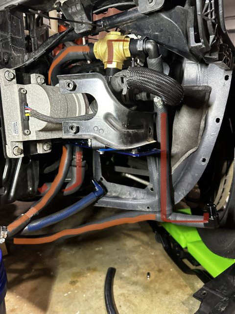

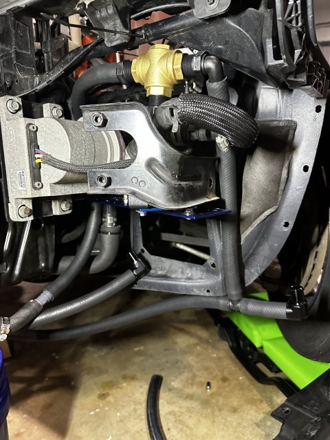

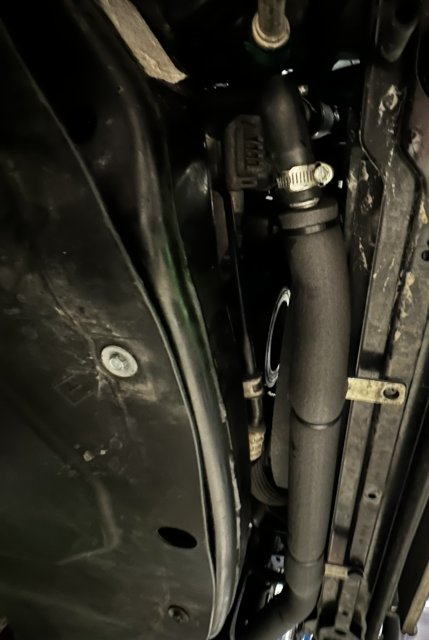

Thread Starter #66

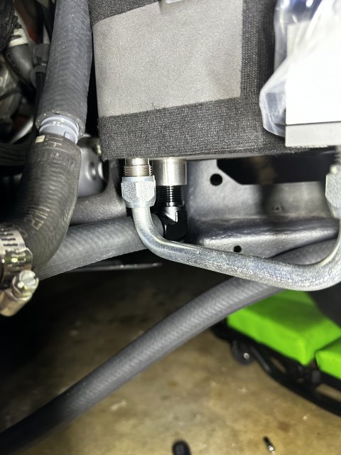

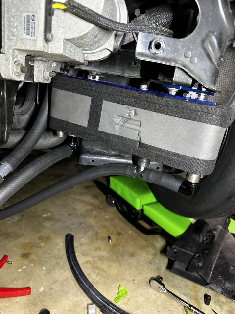

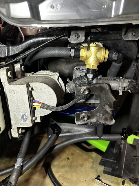

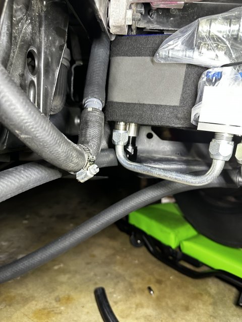

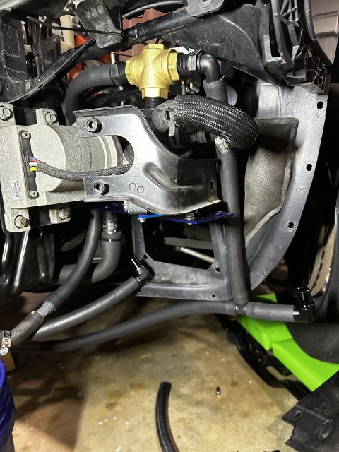

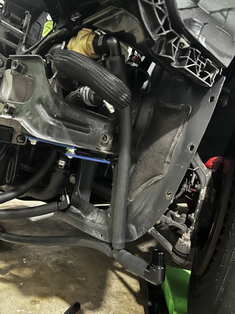

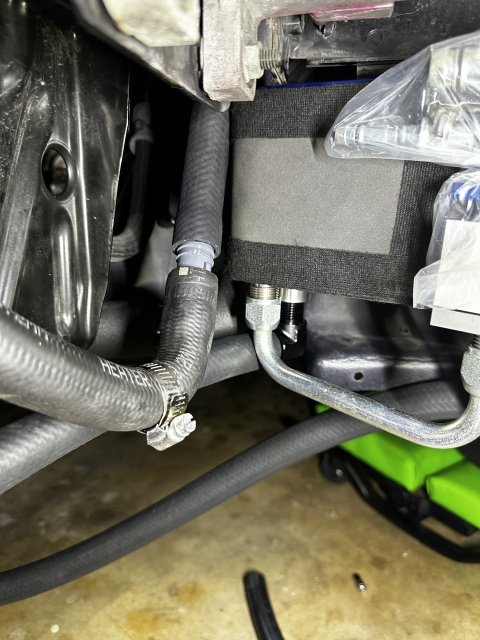

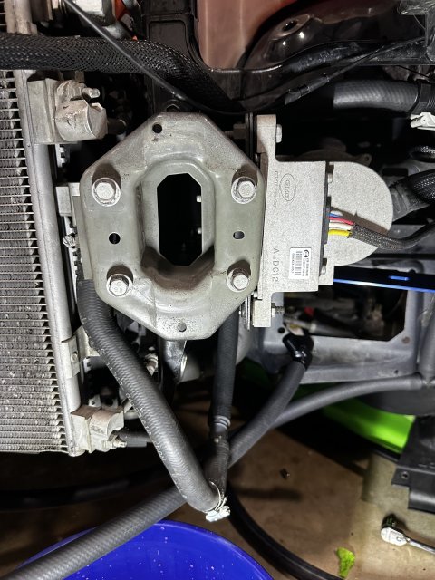

Since no one ever has pictures of how they plumb everything/mock it up before install, here you go!!
mill be adding color to the hoses/direction and theory of operation after I mount chiller, soft mount fittings and take more picture. Have never seen any without the brick installed that shows full line plumbing. Yes, I left hoses long as this is for mock up. Let me know if there are any questions - this is based on ICs updated plumbing
IMG_1607.jpeg IMG_1603.jpeg IMG_1602.jpeg IMG_1600.jpeg IMG_1601.jpeg IMG_1596.jpeg IMG_1604.jpeg
U
8,694
7,652
Thread Starter #67
Right is hot, left is cold.

Thread Starter #70
Valve off/default open position (normal open)
U
8,694
7,652
Thread Starter #71
Flow. Blue = cold, Red = hot (return from supercharger), Orange = heat exchanger

Thread Starter #73
I think with the new plumbing the theory is that the pump is always pushing fluid into the chiller/chest exchanger instead of pulling from it. Not sure why, would be nice if someone had results of plumbing like this
U
8,694
7,652
Thread Starter #74

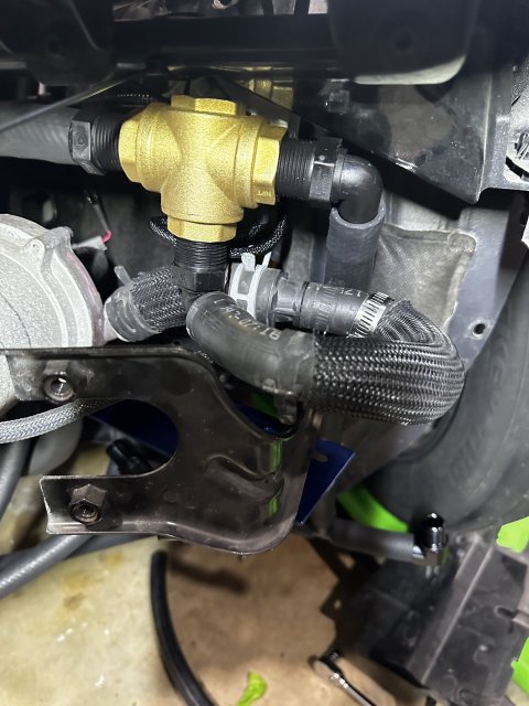

Imo the 3 way bypass doesn’t do much at all because you’re still plumbed into 1 side of the heat exchanger

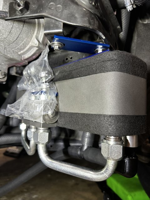

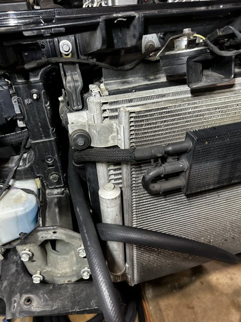

Thread Starter #75

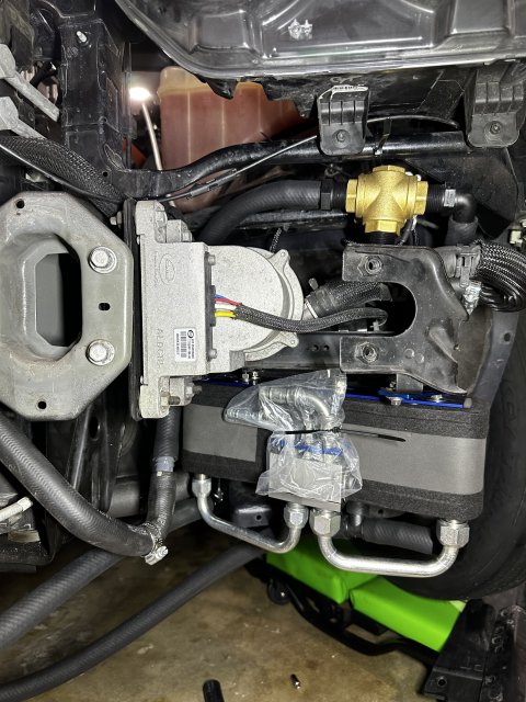

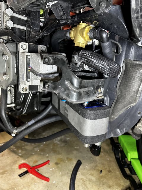

With brick

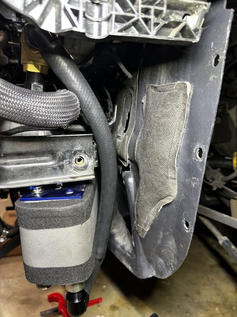

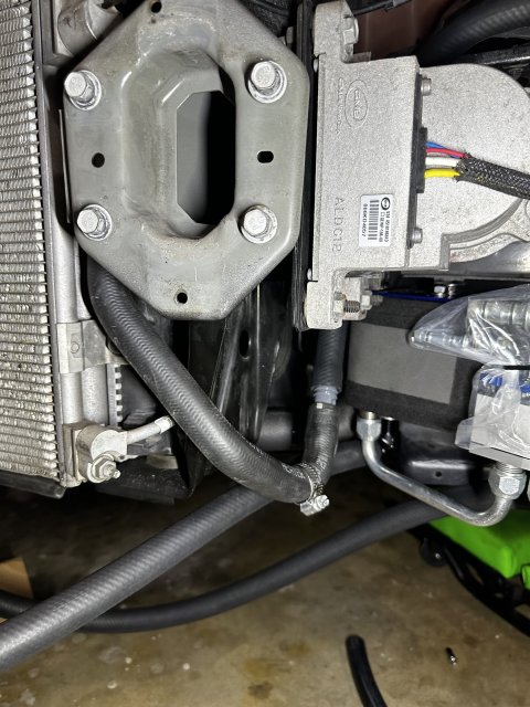

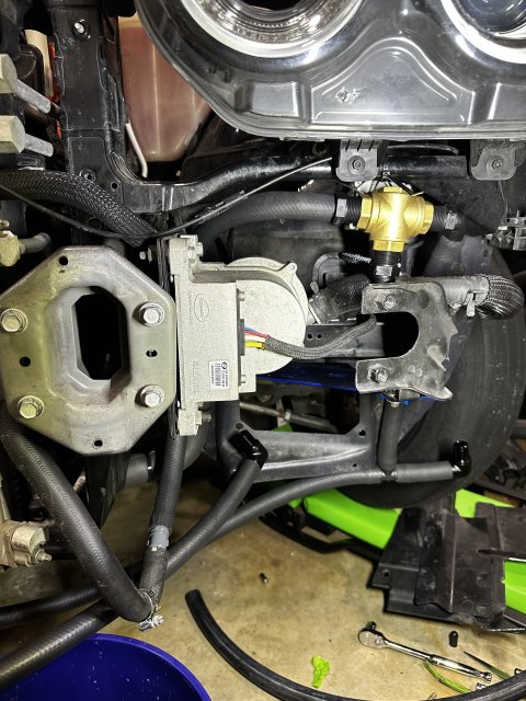

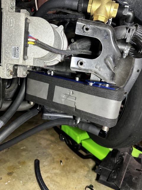

Thread Starter #76
With brick and TXV
IMG_1628.jpeg IMG_1629.jpeg IMG_1630.jpeg IMG_1632.jpeg IMG_1634.jpeg IMG_1637.jpeg IMG_1636.jpeg
U
8,694
7,652
Thread Starter #77
If anyone has any thoughts as to the theory of operation or suggestions on my plumbing I’m open to it

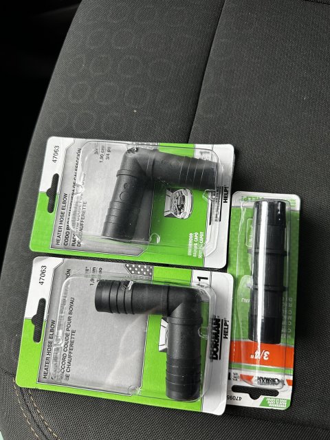

Oreilly’s for the W
