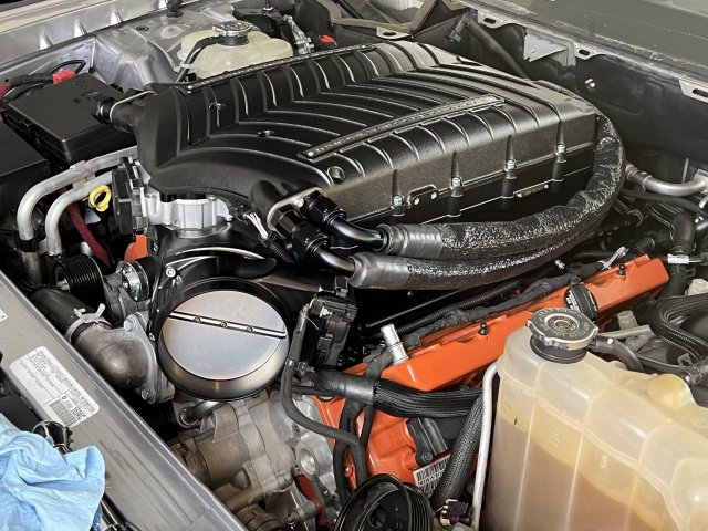

Will be fun to follow a long. I've heard of more than one of those 4.5L Whipples eating bolts from random places unfortunately. Buddy of mine had that happen only the bolt made it past the rotors and trashed his brand new 426 :(
Thanks Speedy, I watch your channel all the time, you definitely seem to have your car dialed in well! Sorry to hear about your buddy's car I would have been furious.
Yep. It was a concern back when the 4.5’s were starting to show some promise. Apparently a number of those got out of Whipple without those screws getting the locktite they needed. Remember WhipCat here? He had one come loose and it got kicked back into the throttle body on shutdown and lodged in the blade. He lucked out. After seeing that I pulled mine apart and did what was necessary.
Yep, that's the case here, no sign of locktite on either of the bolts. I actually read a lot of WhipCats posts and I believe that's where I figured out the wiper arms needed to be bent not to wipe out the bypass valve electronics. Of course I pulled mine and whoever installed the blower didn't clearance the arms and the bypass valve was just one of the problems the car came with. My bolt definitely went on a journey, there are witness marks on the back of the throttle blade, bypass valve, and air inlet before it wedged itself between a rotor and the case, thankfully it stopped there. Anyone with one of these blowers needs to make sure those bolts are loctited and tight IMO.
Had a hate/hate relationship with my 4.5, horribly designed manifold in and out
It definitely wouldn't be my first choice these days, and if the car didn't have one on it when I bought it I never would have gone that route. Also makes regular maintenance a nightmare. That said I think it performs better than a lot of people give it credit for as long as you're working with a tuner that has it sorted out. When I bought the car I had high hopes, but it was put together by a shop that mostly does LS stuff, then tuned by an LS tuner that has never tuned a Mopar before. The first time I took it to the track it went like 10.30 at 133, meanwhile my tune-only 2021 GT500 went 10.16 at 141. I was pretty sour about that. Mike at OST has definitely had this car marching in the right direction though, and it will just continue to improve from here, although it originally wasn't supposed to be this big of a money suck. We all know that's how it goes though lol.

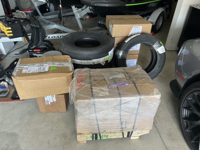

Brown suit Santa just showed up with all these boxes. The Whipple is on the pallet, about to dig in now.

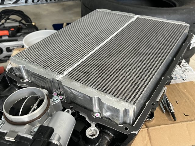

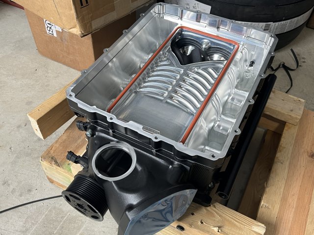

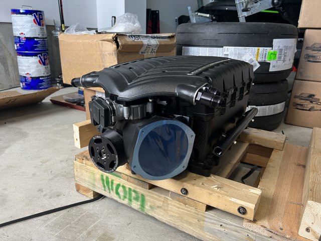

Billet Whipple goodness.

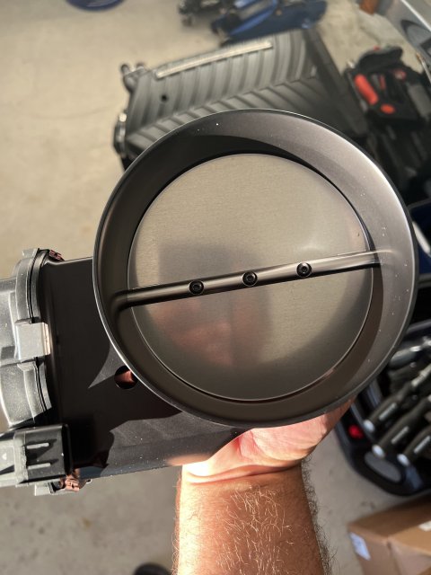

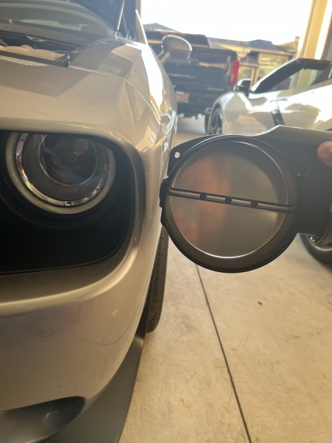

It’s been a good day for parts showing up. Just got the throttle body, legmaker intake and cometic gaskets. Here’s the Nick Williams 130mm throttle body compared to a headlight for size. Sorry for the crappy picture.

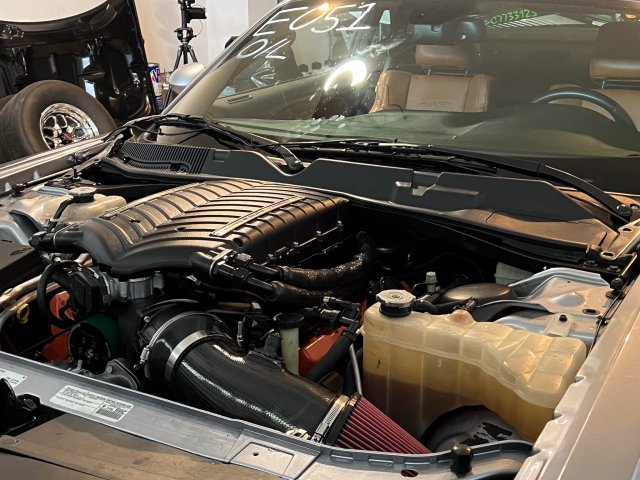

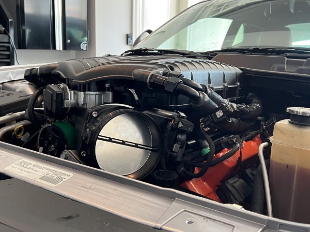

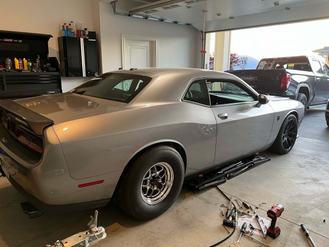

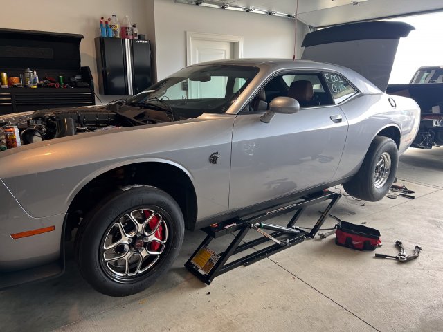

After a solid 3-day thrash the car is back up and running with the 3.8 Whipple. A friend of mine flew across the country to help and we put the blower on along with a whole laundry list of parts I had stockpiled. A few things to note with the 3.8, you will have to notch the metal crossbar that holds the wiper motor and pcm bracket into place along with the cowl in the same area behind the blower if you have the race intercooler as it adds an extra inch of height. The other way to do it would be to space the cradle down to make up the room. This setup will NOT fit under a stock hood which I already knew from measuring it out, so hopefully the Anderson Composites hood gets here soon.
A few things to note when going from the Whipple 4.5 to the 3.8 or likely even the 3.0. If your car has hydraulic power steering you will need to swap back to a stock power steering reservoir, also the coolant tubes for the heater core used in the Whipple 4.5 should be swapped back to stock as the drivers side tube from the 4.5 kit will interfere with the throttle body, at least if you have one of the 130mm units. That can be seen in the picture above my post. What we ended up doing was snaking the coolant hose under the blower like the stock hellcat tube would be and tapped the hole in the water pump for an NPT fitting, which worked perfectly. Other than that the install was fairly straightforward.
While we were at it we installed my AAD rear drag pak kit, TCE 15 inch conversion, GForce Outlaw axles, Per4mance development DIRS diff brace and race brace, rear seat delete and I'm sure there is some other stuff I'm forgetting. I test fit the rear 15 inch billet specialties wheels and realized I need longer studs which totally slipped my mind and would have been a lot nicer to do while the knuckle was off so I'll tackle that next. It also looks like the tire (315/60/15 ET Street R) might be rubbing on the rear shock and I'm going to have to massage the pinch weld a bit more.
Got the car out for the first drive last night and what a difference over the old 4.5. Still need to get it tuned so I didn't get on it too hard but rolled into it from 2500 RPM in 5th up to about half throttle and 5500 RPM and the car pulled surprisingly hard. Hard enough in fact it looks like it hit a torque limit that it never had problems with running full out with the 4.5, so this thing should be making a good bit more power.
Here are some pics.

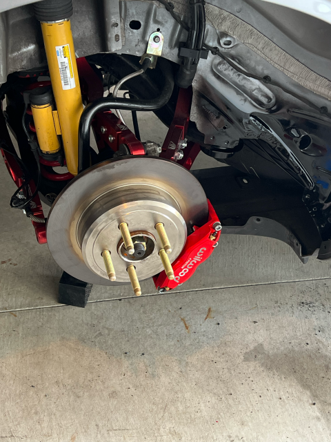

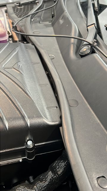

Over the weekend I got the longer wheel studs in, along with the AWE resonated touring exhaust. Also handled a few other small things that needed to be taken care of. After talking with Whipple I found out why it seemed like the car was hitting a torque limit, the drivers side maps need a T-harness that will keep the computer from reading the MAP reading on the drivers side front map sensor by the bypass valve. Got that installed and taken care of as well and will hopefully get to drive it and get some logs for Mike later today.

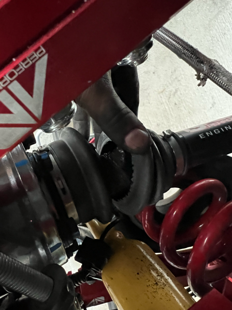

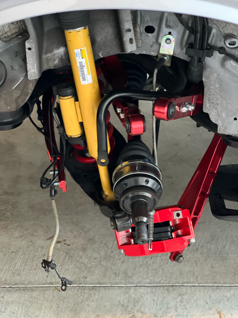

Somehow the axle shaft boot on the drivers side is torn completely around, I really have no idea how this happened it's a brand new Gforce outlaw axle with less than 10 miles on it. Does anyone know if you can just replace the boots somehow or am I stuck buying a new axle shaft?
Also I've beaten the crap out of the ribs in the rear fender wells, and cut and folded the pinch weld over and my 315/60/15 ET Street R's still rub a bit in that spot. I'm not sure if I'm missing anything or if I'll have to use a small spacer.

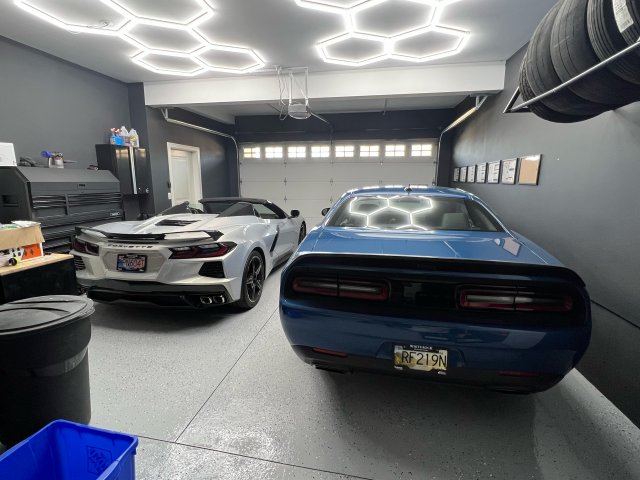

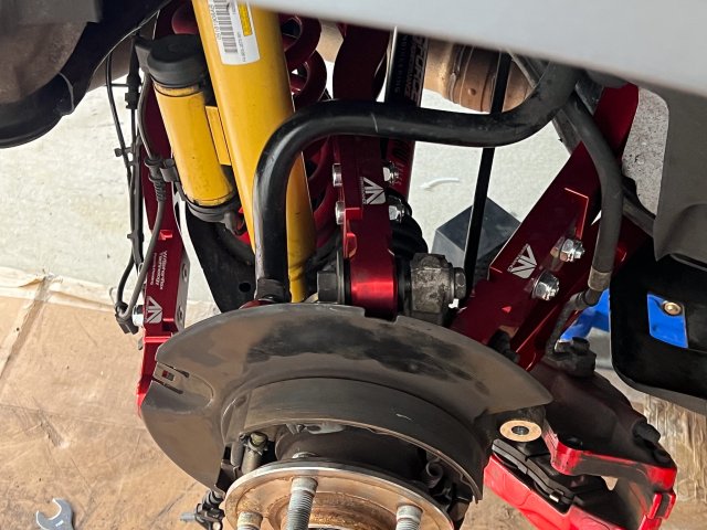

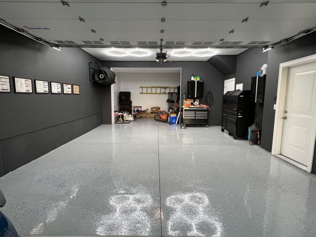

Just spent the past 9 days overhauling my garage. Now I can get back to working on the car, which is currently an hour away from home with a cut-through rear brake line. I definitely should have checked the routing of everything with the car on the ground, but live and learn.
View attachment 107386 View attachment 107387 View attachment 107388 View attachment 107389
Yes, I use a spacer - a lot of people do. Completely fine with the longer studs
I don’t think they’re rubbing since the alignment but I did pick up some 3mm hubcentric spacers just incase.
