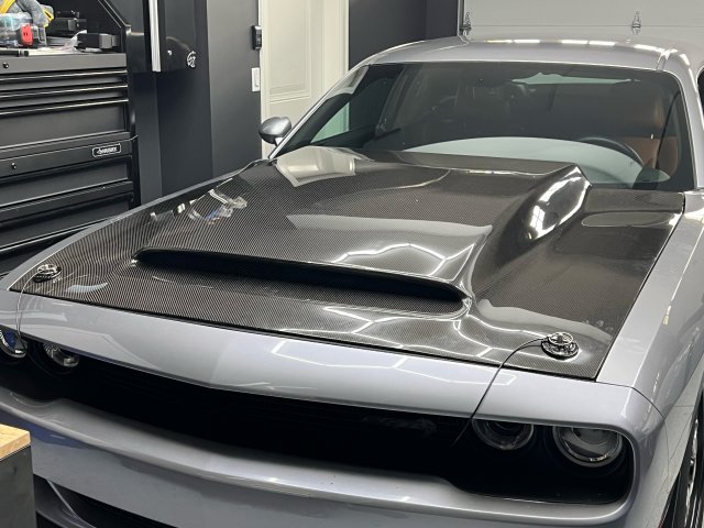

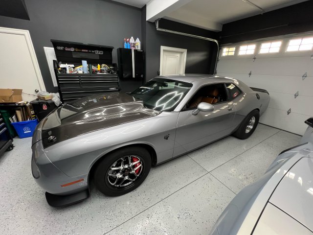

Anderson Composites Demon Cowl hood showed up this morning, 1 day after a car show that I had to show the car in for my work lol. Was an 8 hour reminder that I generally really hate car shows.
Anyways the hood fits and looks great, I'm definitely impressed with the quality. That said the landed cost in Canada for this hood is through the roof but I'm happy with it regardless. Drilling for the hood pins was incredibly nerve-wracking, but it all worked out just fine.

They are beautiful. Did you by any chance weigh it before install. I would be curious to know how it compares to stock.

They are beautiful. Did you by any chance weight it before install. I would be curious to know how it compares to stock.
I know my redeye Anderson composite hood weighs 5lbs more than my stock 2016 hellcat hood.
I didn’t unfortunately but just from feel I’d say @RGPIII Is right on the money.
That’s what I was thinking. I believe the dry CF is considerably lighter. I know the dry CF deck lid and roof panel are significantly lighter than stock and something I would like to go with but for the high cost.

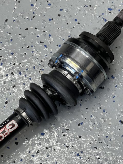

Finally got around to swapping the drivers side axle shaft with the torn boot out. Should have this back together soon and then going to try the race gas tune out at the track tonight for the first time.

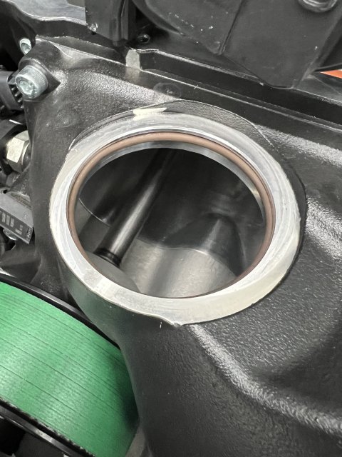

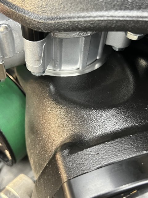

I took the blower lid off the Whipple today and noticed that the O-ring for the bypass valve was just sitting on top of the snout against the bypass valve, instead of being in the groove where it is supposed to be.
I got that sorted out and the car seems to run better and pull harder. I imagine it would have created a vacuum leak but based on where it is I’m not sure how much it would affect things.

My 60’ should be a lot better next time out. Have a few things to try and installing an ice tank to take care of IATs. If the bypass wasn’t sealing you definitely had a boost leak
Mentally this is one I'm struggling with, the car feels and runs a lot better under normal driving now. But under WOT when the bypass valve closes would it have a boost leak from there? I can see that it could still leak from the snout, but I'm not so sure about having a boost leak from the blowoff coming from the blower lid at that point with the bypass closed.
Maybe I'm looking at it wrong and over complicating it in my head.
I’d think you’d be sucking in unmetered air. Did you get logs? Your tuner should be able to spot it
