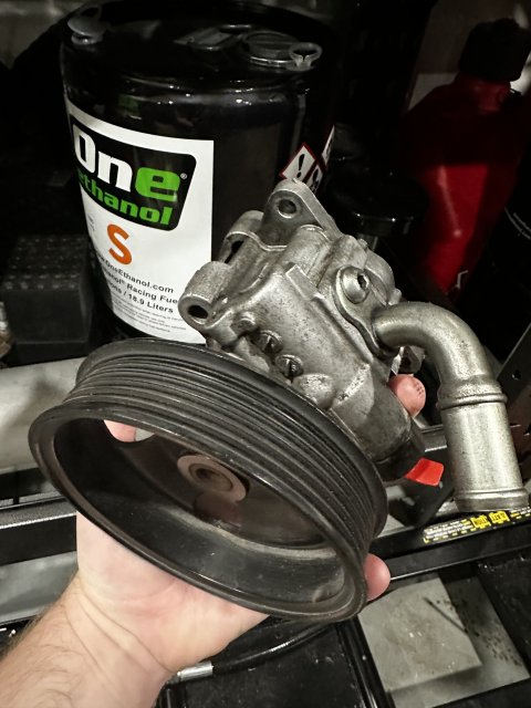

I have an elbow that bolts onto stock pump to make it remote btw, I think you have a AN fitting welded on yours right?

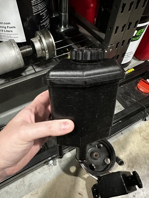

Here’s one solution. This pump is for sale as well (2015 challenger hellcat pump with fitting for remote tank)

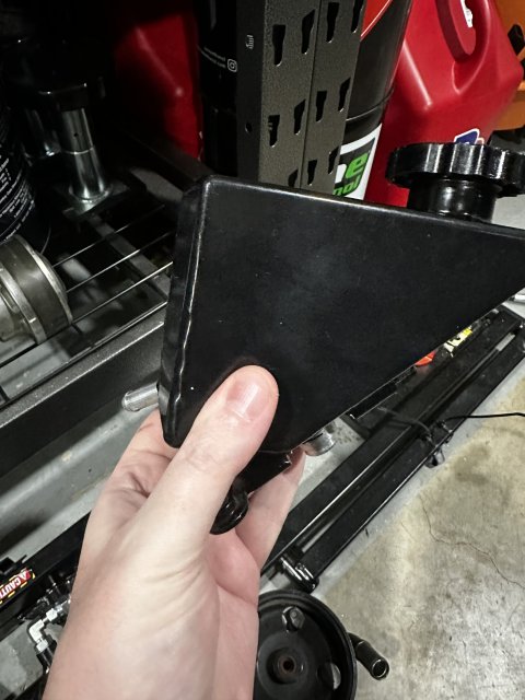

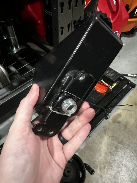

I also have a metal tank from a whipple 4.5 that bolts to the top of the stock pump, you reuse the mounting bracket from stock pump/plastic tank. just needs an o ring (I have some laying around)
View attachment 113395 View attachment 113396
The reservoir cap on the metal tank needs to be relocated to the other side for that to fit.
Good to know!
