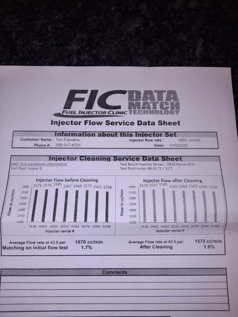

How much to clean them? I have never sent a set out to get cleaned. My friend Tim sent his out running 8's on e85 this year and before and after flow was basically the same
16,879
52,876
Test and clean, and shipping, @ Havoc Speed - $175.59

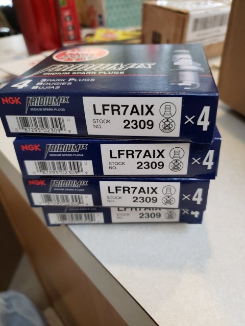

I've got a whole box of plugs from Orange Krush. I need to go out and see what they are, 2309s I think. Back in the day you had to be careful to use the right plug as some were taper seat (SRT 6.1 blocks) and some were gasket seat (5.7 blocks). I'm remembering the Hellcat is gasket seat.
When I was looking around at plugs there was a guy that said his tuner told him to get a certain NGK. I pulled it up and compared it to the 2309 and the difference was it had a tapered seat. It was the same heat range. The Hellcat uses gasket seat like the 2309
