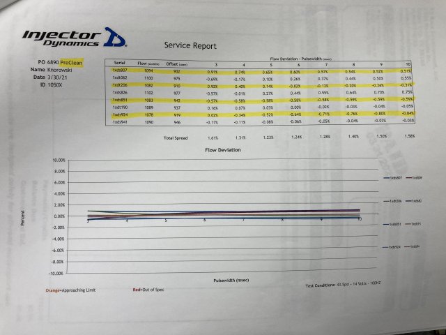

How much to clean them? I have never sent a set out to get cleaned. My friend Tim sent his out running 8's on e85 this year and before and after flow was basically the same

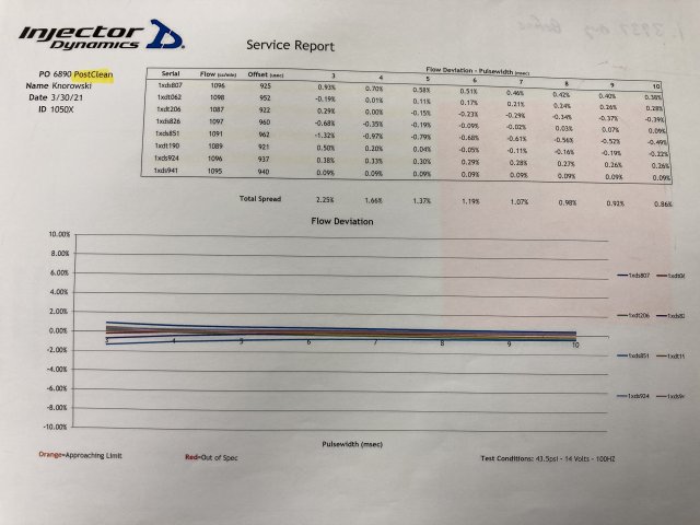

I sent my ID 1050X’s to ID for cleaning, about 9,000 miles on 93, 4000 on corn, as sent basically same as returned. Interesting thing was for 1050’s they flowed almost 1100 cc’s, no wonder they keep up with E85 and 18 psi of boost. 6BAA33E3-8B91-4949-9EA6-BD7E054D2F86.jpeg B2D65CCC-0AEA-4B13-A7D2-41D9E17DC4DF.jpeg 2D67E8F7-1A50-4B66-8A16-4AFF522D7A59.jpeg

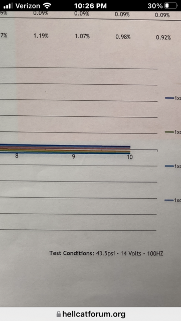

At what PSI?? Most places test at only 43.5psi
It’s on the reports, bottom right, 43.5 psi 14 volts 100 hz

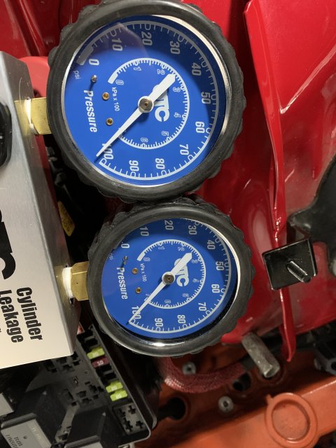

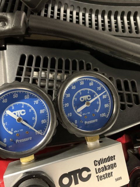

Well some good news and bad news. 7 of the cylinders tested at 2 or 3 percent on the leak down test.
Cylinder 4 on the other hand well. Not so much.
the first test I did showed 12 percent. Which isn’t horrible. But I wasn’t 100 percent sure I was tdc so I went to test again and we’ll I heard a noise and the engine filled up with air and came out like crazy from the oil fill. Ever since the. I did 6 more tests on the cylinder and it was down 25 percent each test. So I guess today I’m going to put it back together let it run for 10 or 15 minutes giver her some revs and test again.
I tried a few different ways of finding top dead center. I did end up like using a compression tester the best to find it. Once the compression tester had compression (only a few pounds) from turning the engine I knew I was at tdc.

I guess I wasn't clear.
Do you have a cylinder at ~25% leakage??

Man, I'm off my game, went back and read the post before.
I think you need to ensure you're at TDC or you'll have bad results.

I have read that you're supposed to rock the crank back and forth to seat the rings as well.
That’s why I’m going to start it to try and set everything. Like I said there’s still a chance.
the pics above was once cylinder off 25 psi. It was cylinder 4 that had the broken plugs. The rest were all about perfect and that was the second pic.
