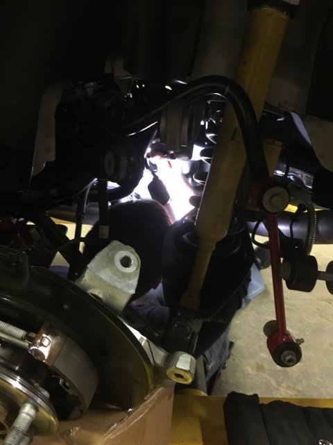

So my tips for anyone who has not done axles on a car.
Obviously disconnect everything. Sway bar link, control arms, trailing arms. Take the caliper off as well. I zip tied it up so it didn't dangle.
There's a 12mm bolt with a nut on the end. Take this out!!! I saw a video online and they said they didn't have to do it. Well that was my hold up all morning and my struggle once I took that out came right out.
If you end up taking the hub off I had to hit it with a rubber hammer.
Don't pry against the axle. I didn't know it but new axles don't come with that end piece.
A screw driver was enough to pop it out of the diff.
After doing the driver side and struggling the passenger side only took me just over a half hour.

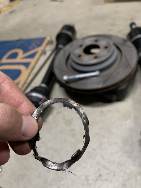

How did the washer/shim look on passenger side? You may want to post a pic of it. Don't remember what it is there for but you need to replace it
It was in good shape. But I don't think it does much I'll post the pic I think I have it on my phone. Joe told me not to worry to much about it when I showed it to him.
Did yours not have it on there?

Is this needed. I prayed on this side
58,931
203,516
I'm sure it did but we were not prying at that end so they would not have been damaged
4,899
16,525
2025 Dodge Durango R/T Plus
It’s a spring retainer. Not a washer.

so I did end up watching your video later on. The one or two other videos I found said they didn’t move the 12mm nut on the hub. I watched your video and decided to remove it. Came right off 😂
O well I learn my lessons the hard way now I know. I got the passenger side out in a half hour. Not hard at all once I knew what was going on.
We just called a washer. It looks like a retainer but not sure what it is retaining

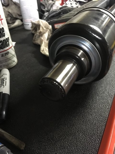

I'll ask again, did you get that piece of axle out of the diff. ?
58,931
203,516
not yet
58,931
203,516
There have been enough broken axles but there are no videos on how to get it out. Jon said a rod would have to be no more then .25 to fit in there to try to tap it out from the other side
