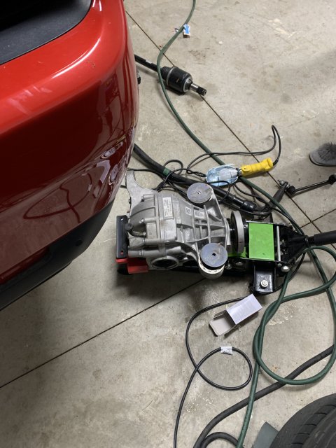

My cousin brought me a screw driver that was .25 to bang out from the other side. It wasn’t skinny enough. So we have one more idea to fit through there we are trying tomorrow if that doesn’t work we are probably pulling it out from the side that broke.

Thanks for the reply back for him :unsure:, I think if that piece of axle is cocked sideways in the diff ?...that's not good, axle slides straight in & does not articulate like that.

I always said I’ll replace the axle when it breaks. Little did I know they break in side the diff as the weak point.
crazy thing was wheel hop didn’t happen till 25 mph and I was running 20psi wheel pressure

I’ll get it out one way or another. I didn’t do anything to it during the week. My cousin works seconds and I will be waiting for him if we thread a bolt in to pull or anything f welding is involved I may get a friend who is better than me.

I hate to say it but if that piece is in there sideways (haven't heard you confirm that) it's time to drop the diff & replace.
It doesn't look side ways but I really won't know the damage done or not done until it is out
so it looks straight in the hole ?

Trying to get the axle out in car wasn’t working so out she comes.
