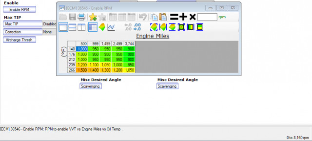

There is also a threshold of 3744 miles before you get full VVT functionality... and it really does treat those first 500 miles as critical and looks like it neuters you.
I have a "normal" 2017 Hellcat. So will my car feel or be faster if I ever hit 3,744 miles? Sorry just don't follow you here....
I pulled that chart from a Trackhawk tune. I can look at the Demon and HC tunes to see how consistent the thresholds are from platform to platform. But, yes once over 3744 miles the PCM will reference those values and the VVT control will occur sooner (more torque?!).
