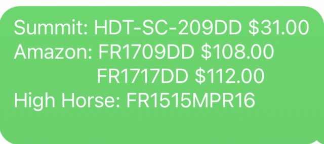

Prices are probably not correct anymore but those are all the parts you need. You will also need to cut the DD shaft shorter.

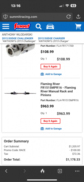

All items purchased. Will be calling you when I get the car back on the lift! Thank you!
Summit has a promo code out there “RACE” if anyone is looking to purchase.
