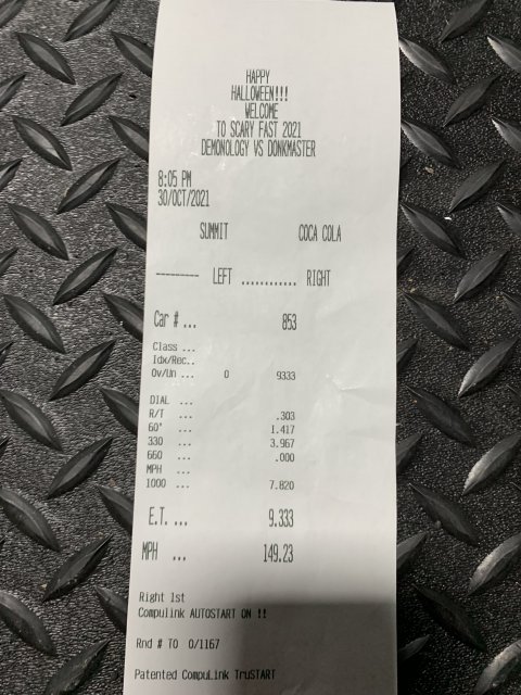

New PB, was looking for 9.5-9.6 and went 9.33 @ 149.23 8E6025E4-229F-4F9D-A2BD-F10BBABB9F85.jpeg

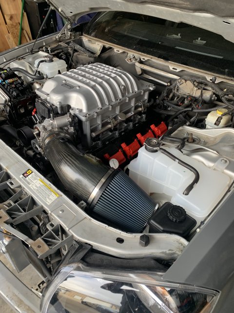

Since I have not been working on my car, I started on this project. It is on a 2005 Dodge Magnum RT, stock 5.7 engine. 948AD168-5DB7-4D8D-99EF-2BA46EF5D91C.jpeg 6297E48D-0BBB-4EE1-AE15-DE61E87AA973.jpeg

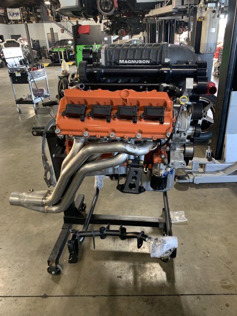

Old motor is out, may have this thing up and running by the end of the week. 344444C7-60B9-4FCE-AF04-82AA97BBA17D.jpeg

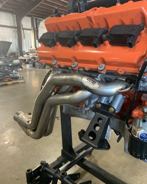

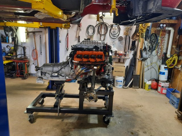

Thread Starter #72

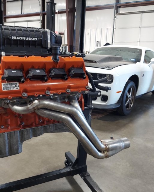

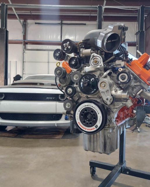

A little mock-up on the new motor, still waiting on a few parts to come in so we can get it installed and tuned. 707E1836-B95A-4C82-9278-1BD8468A5741.jpeg 1690B392-0651-4B95-B032-ED6A2BF9BE3D.jpeg 2E49E9AB-8012-48B2-8DB6-61F417EF76C0.jpeg 2D253308-0247-475C-8938-9182824A1F54.jpeg

Real curious what happened to the original 426.

Thread Starter #74
@Speedy! the original motor was the stock 6.2 no upgrades. I have not pulled a head or the oil pan to check but I suspect a bent rod. No damage to the oil pan or block and all the intake valves look good, oil was not milked. I am going to pull the head when I get the engine back to my shop and will see what happened. We were about 18lbs of boost and making over 1000 at the rear wheel so I am pretty sure it bent a rod.

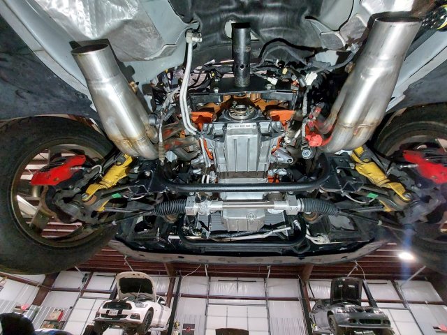

I really like those solid mounts but wonder what it would be like on the street.
@oilburner my car is probably 95% track use and rarely on the street except to have the state inspection done and when we do the cruise for the street car class races. I have not ran this motor mount setup before, once it is running and I have a chance to drive it I will post here how it feels. I also pulled all the power steering off and went with a manual rack and pinion and had a custom built tubular cradle made.

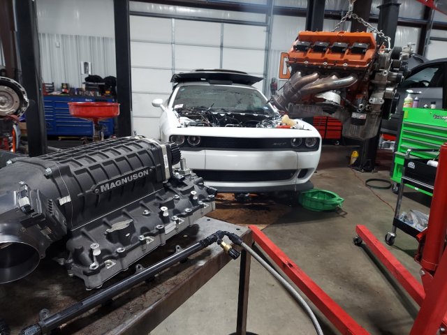

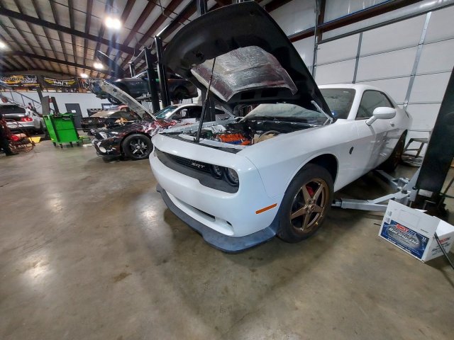

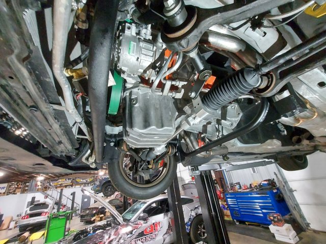

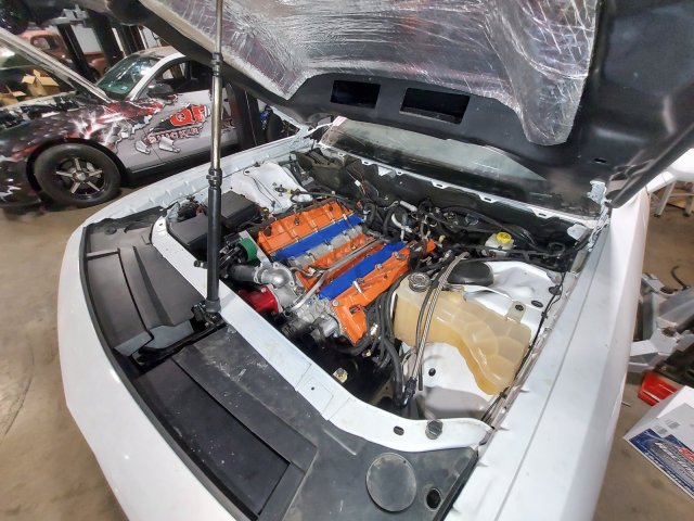

Thread Starter #78

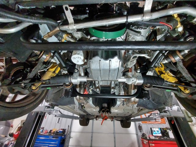

More progress, new cradle, manual steering and engine are installed. Still waiting on a few small parts to install the Magnuson and the new Sipple Built transmission. Got the cage set-in the car and will start the install today.
45FB2BD5-DCFA-4C43-81D9-1A0EC8951F31.jpeg 73D0F01E-8E0C-4205-940F-AE804F12BF50.jpeg 325A8FD8-6921-4254-9870-26DFD38634D4.jpeg 3518926A-6522-4C1F-89A9-9650B14DA536.jpeg 916E4B28-6AE7-4A9E-A931-6D6A739EFEEB.jpeg 7B2E7CB6-05B6-44B4-8B36-ADE1E75E4076.jpeg

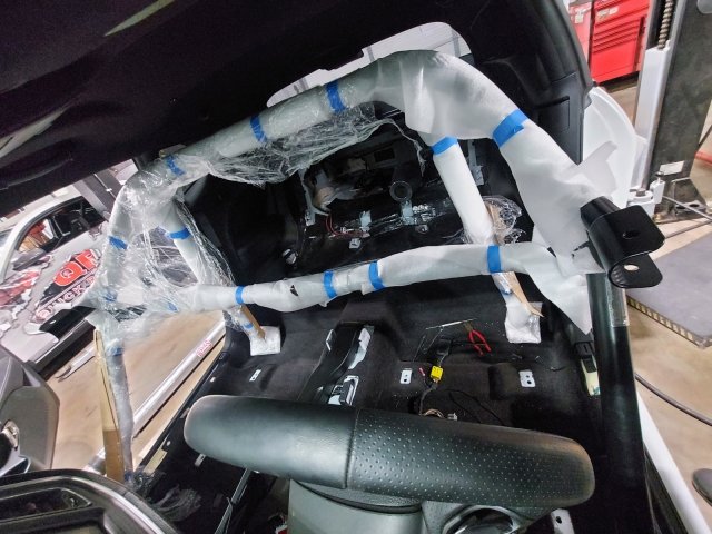

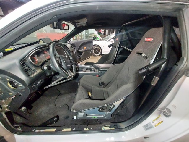

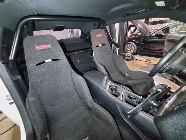

Thread Starter #79

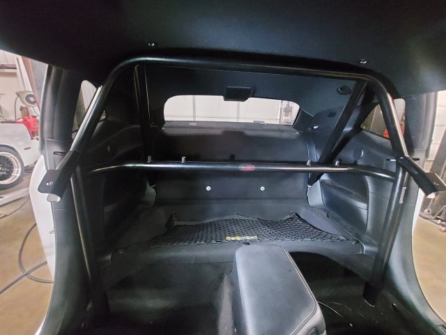

Rpm Rollbar is installed along with the Kirkey seats 94EABC4C-3882-4EFE-AC95-489804B5163A.jpeg 9A575E2F-AD8F-451D-B0CB-91544F7C0CD4.jpeg 4F716B89-08AD-4741-8ED3-1F1778A0CB37.jpeg

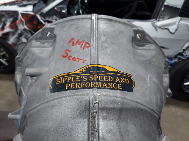

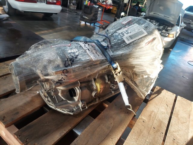

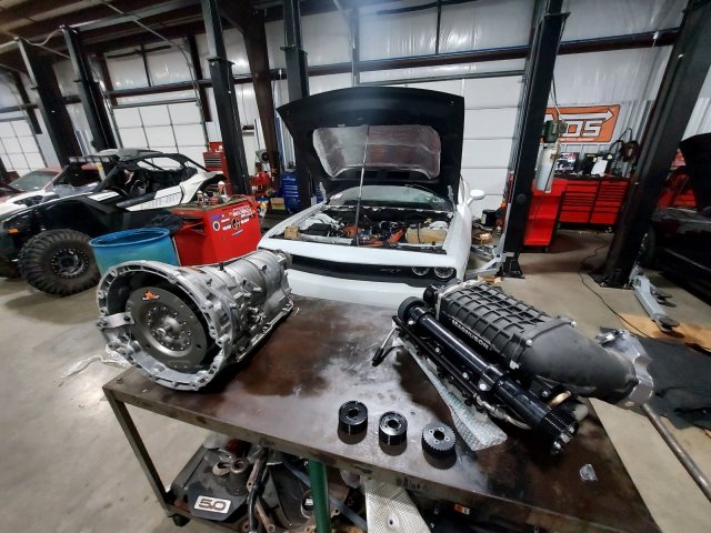

Thread Starter #80

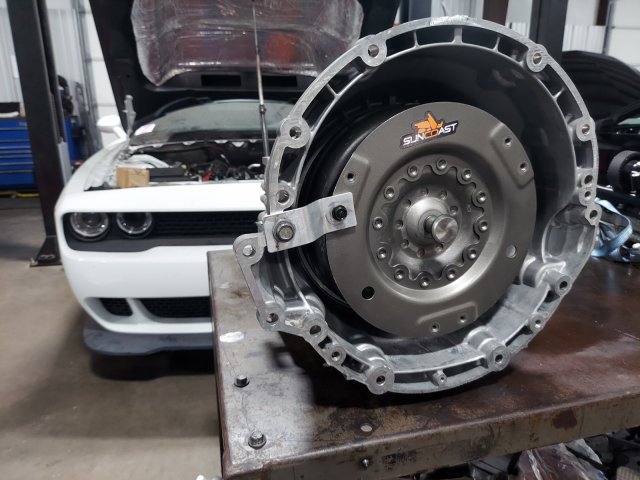

The new transmission and torque convertor were delivered and are ready to be installed. This is the Sipple Speed and Performancr Max Effort package with a SunCoast 3300 convertor. 898F6323-F6D5-4651-AFA9-62CEB6176CE7.jpeg 1818AF95-8B0D-4D6E-8FA1-DA4C05D1786B.jpeg 54B44EE1-8118-44A4-8F3C-DA7AE3F48693.jpeg F22C7233-7896-4F86-BC64-2DF5E919E40E.jpeg
