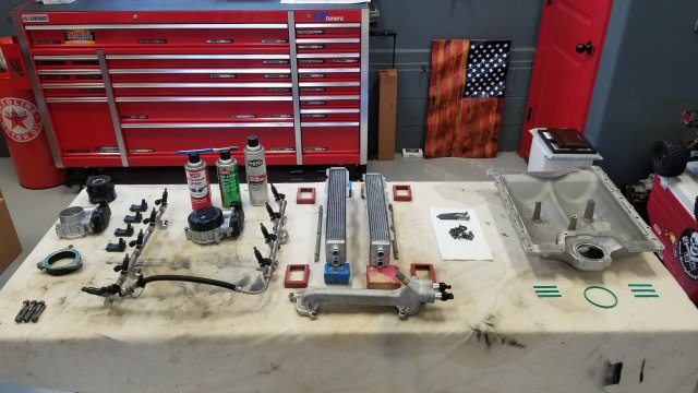

Thread Starter #159
All cleaned up.
1,588
3,954
looks like the Doc is prepping for surgery :)
