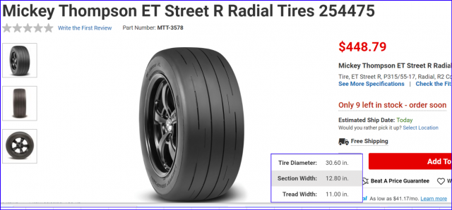

Ordered these ET Street R's today as they were actually in stock, unlike all of the pieces I would need for a 15" conversion. Will try this in the meantime. It's gonna be a big tire, but looking at the specs, it's only .4" taller than my street setup and section width is actually slightly less than my street setup (Hoosier DR2's 325/45/18). Hoping I don't run into any issues with fitment given those details.

Breaking News... The 2021 Super Stock just got another new best at the track last night! Left off idle and rolled into throttle as quickly as I could netted a 1.39/6.29/110! Tried again later on after the sun went down and DA went to 800ish, but had traction issues. Thinking about switching to the Mickey Thompson ET Street R 315/55/17 I've got sitting here. But having reservations because of the 38 lb tire weight compared to 25 lb Hoosier I'm currently running.

Yea, tough decision on the tires, hard to say if the reduced wheel speed from the much taller and heavier tire can be overcome with MAYBE better traction ?

Also, IMO the 13 lbs of rotating between the MT and the Hoosier can pretty easily be made up w some early timing. My 15" beadlocks w the 315/60 MT are a total of 28lbs heavier for the pair than my BS/Hoosier setup and my similarly tuned car had no issues pulling them.

Good to know! Obviously I'm still on the fence about this, but that helps a lot! Were you stalling it up when you got some of those killer low 1.3x's?
