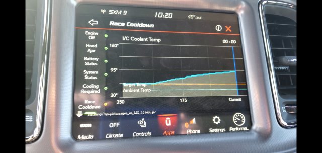

Any thoughts or ideas on why the chiller wouldn't activate?
It may have been too cold out? I didn't think it was under 50° but will have to go back and look at the weather.
55 deg.

That explains it, and actually now that I look at this pic below the car said it was only 49° even though the weather data said 52°. Now if I could just get the race cooldown feature to work, that would be helpful. It had all the green checks on the criteria except the bottom one which was "race cooldown" itself which had an exclamation point. Screenshot_20220407-085309_Photos.jpg

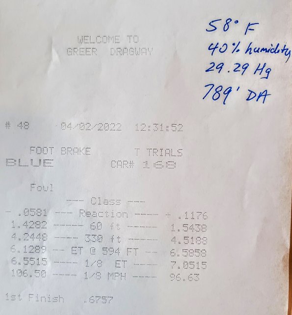

Density altitude for my best pass was still 789' even though it was in the 50s. We never have the negative DA here in upstate SC like some of the other states get. This is about as good as it will get. I may try to run again Saturday morning but not sure what else to try other than removing my passenger seat. What is everyone's opinion on launch technique? My 1.42 60' was leaving around 2000 rpms. 20220407_085800~2.jpg

Good pass!... and per my best pass ever.... just for comparisons and to estimate your 1/4. NOV 2021 at Cecil County.
I went 1.41 60ft (on stock Nitto DRs) w/Demon front skinnies, rear seat delete, "I'm 265lbs" & rear brace.
330 4.19, 1/8 6.49 @ 106.88mph, 1/4 10.16@133.30 mph. about 50* DA -900 or so. (all stock 2400 miles)
