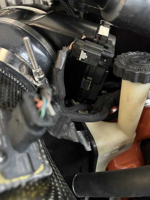

On 3.8L, The big throttle body motor hits the power steering reservoir on cars that still use hydraulic power steering. You’d have to come up with a solution for that like remote mount the reservoir, convert to electric power steering, modify the stock plastic reservoir, or whatever idea you can come up with that you can implement.
I have the Nick Williams 130mm TB on mine and the stock reservoir clears it.
If you flip the TB to face the motor away from the rail, I would imagine it does. My hood doesn't clear it though.
It’s close, but fits. Does your 3.8 use the stock By-pass or is it the race version?

Yea, mine didn't clear, not even close, nor did it clear for many others I tuned. Perhaps they adjusted the adapter plate design to clock the TB differently so that it does after receiving feedback about it.
Yeah that’s the likely scenario.

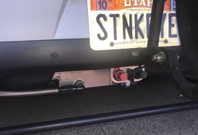

I made a remote reservoir so I have a plastic one if you need
I’ll buy

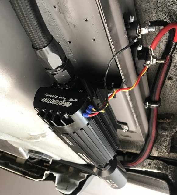

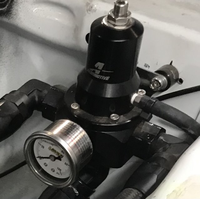

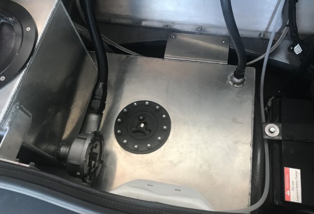

I have a 12 gallon fuel cell in the trunk that has a sump. That was necessary due to the 4-link requiring the removal of the stock tank. I have the 8 gpm Aeromotive external gear drive pump. No reason the Dominator won’t work with a capable Fore system. Also no reason you couldn’t dump that heavy OE tank and go with a light weight cell. EE1E65C7-FB3A-4AC9-B2C4-C241554A573A.jpeg 30D3BE55-6C64-4A9A-BCF8-A5124BF18098.jpeg C53401E1-06E9-4141-BCFE-72453C5518D5.jpeg 5F735AF8-8419-4685-9EAF-E27ED0D1BB53.jpeg

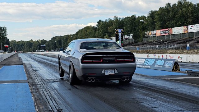

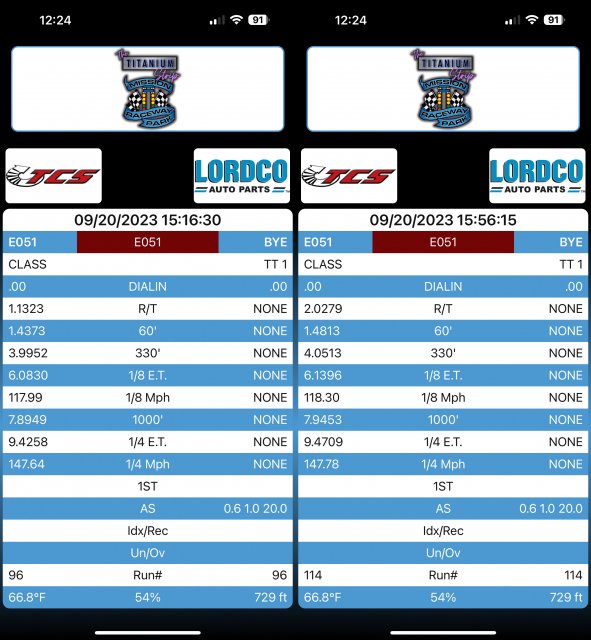

Well, it's been a while since I have been on. I finally got the car to run somewhat where I thought it should be.
Ended up with a best of 9.42 at 147 after throwing the 3.5-inch pulley on it. I think the 3.5 finally gets the Whipple 3.8 in its efficiency range as the 4.0 to 3.75 barely made any difference, and the 3.75 to 3.5 was worth 3 MPH and almost four-tenths.
Unfortunately, I ended up cooking the trans. I had a feeling it's been on its way out for a while now, and it finally decided to give up the ghost. As soon as it warms up, it starts slipping every gear change badly and eventually puts the car into limp mode. I know going to the TH400 is the way to go with my end goal for the car, but I still have a hard time making that decision due to all the other changes I'll have to make. I think realistically with everything I want to do to the car in the off-season, TH400, Holley EFI, new rear end that will be required due to the TH400, new engine combo, cage, parachute, fuel system. I probably won't have the car back out next year, but it probably makes the most sense to just do everything at once and get it over with.
View attachment 117629 .
Hopefully I get everything done and get it out for next year, but funds/time will be the deciding factor on that.

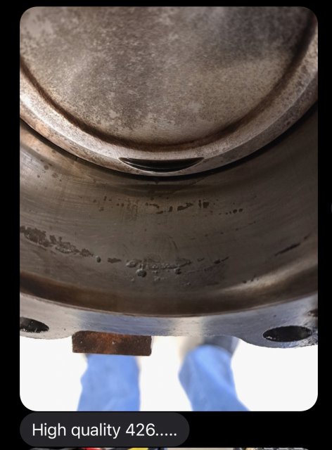

I did mention that it looked like I had a 426 shortblock for the car a few posts ago. Upon tear down it was no bueno so I’ll likely buy a rotating assembly and have my block machined.
