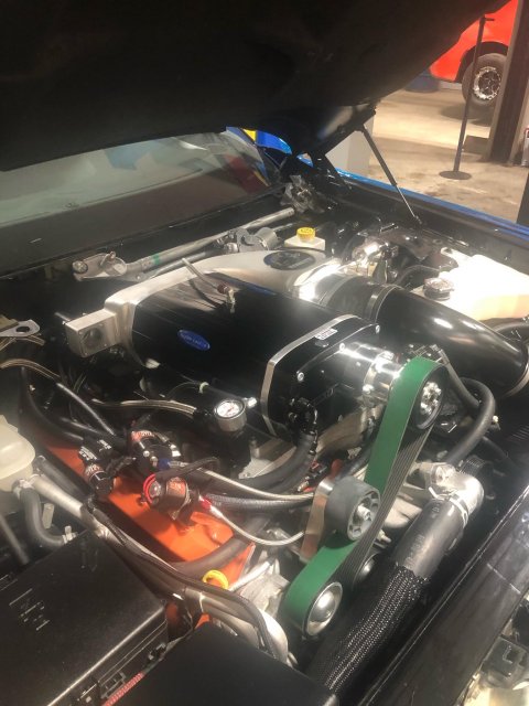

I still have high hopes for the little Maggie. This whole snafu could be because of a bad tensioner. The report is that the American Racing Solutions billet tensioner proved to be off when the laser was used to check alignment. These tensioners have proven to be good on many of the high boost cars that have used them (mine included). So getting a oddball would just be bad luck. For those that are learning.... the stock tensioner has a very weak spring in it compared to the billet version. Like much of the issues us “R&D” folks run into..... it was designed for 11 lbs. When you throw 25 lbs at that belt, it slams that stock tensioner to the stop like a hammer. A number of them have broken as a result. One thing some don’t realize is that the belt stretches when working against the force it takes to accelerate the blower like this. That’s what the spring loaded tensioner is there for. To keep that slack under control. The idler pulleys are added if necessary to increase the wrap on the supercharger pulley so it has enough belt on it to do the job without slipping. This is where the Magnuson layout is lacking. Without idlers, it doesn’t have enough belt wrap to start increasing the boost past a certain level. I don’t know what that level is (stock?) but James here has exceeded that by a bunch. He went to 25 lbs instantly and past 900whp by just over 4000rpm when the belt let go. So this is where the two steps forward/one step back part of “R&D” comes in. Put the stock (straight) tensioner back on to address that problem and go with a less aggressive pulley on the supercharger. I am going to suggest getting some video of that stock tensioner and supercharger pulley while reving the engine and then put the camera on a tripod to see it on a full pull on the dyno (I know I sure as hell wouldn’t be standing that close during that). Anyway... I predict that the aftermarket will address the belt issues for Magnuson and will come up with the necessary dual idlers and other pieces to get the job done, and then Magnuson will follow with a factory package once all the R&D has been done for them.

Can you buy an adjustable idler pulley? In the picture above that looks like the supercharger pulley is adjustable. I have the after market 3 inch metco idler pulley. I was thinking of going to their 3.5 inch idler pulley.

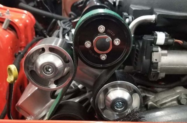

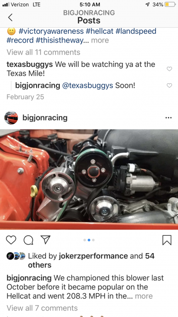

Well woke up to some good news. This set up might be available to purchase soon. They are quit a few requests for his custom bracket and pulley set up.
I told him that I’m first lol. 7C257E3A-52AE-4B05-A062-D822480EA37B.png AD3FE315-F798-4C84-97E5-EFA0527600DA.jpeg
I have a Tim Barth adjustable idler pulley on the car right now. Tommy put the 3.5 pulley back on and put a knew belt on it yesterday. He is gonna do some street pulls and see if everything looks good. If so I will wait till this bracket/ pulley combo is available to purchase. Then after that we’re gonna put the 3.25 on turn it up.
3,279
10,401

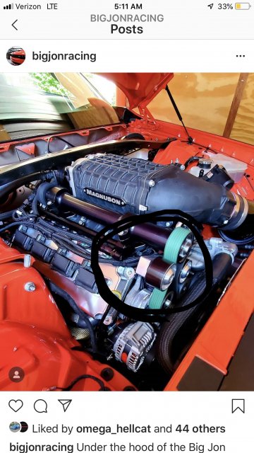

You need to crop your pictures! That dual idler setup is as trick as it gets. Magnuson...Wake up!!! 250C1440-35BC-49D4-8ACC-47D2CEEEA99E.jpeg
