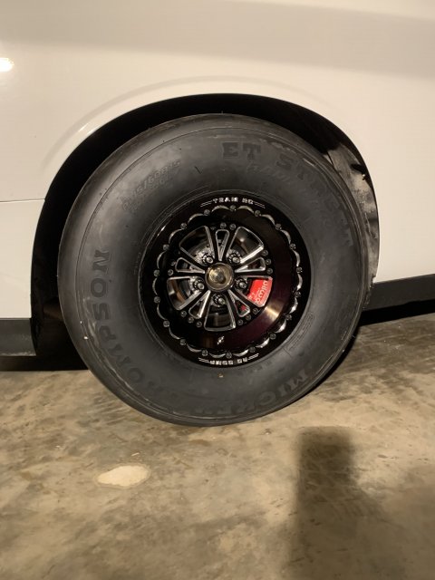

Got the new rear wheels and tires mounted up. 0B1A899C-2B81-4BC8-9DF1-8F4D0B151AEF.jpeg

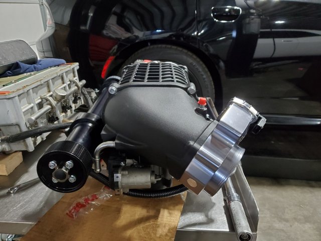

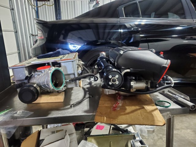

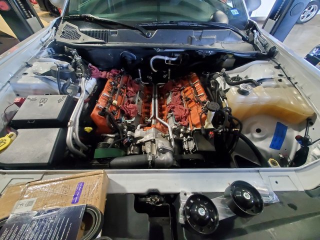

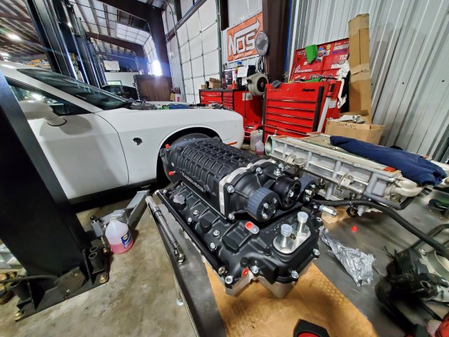

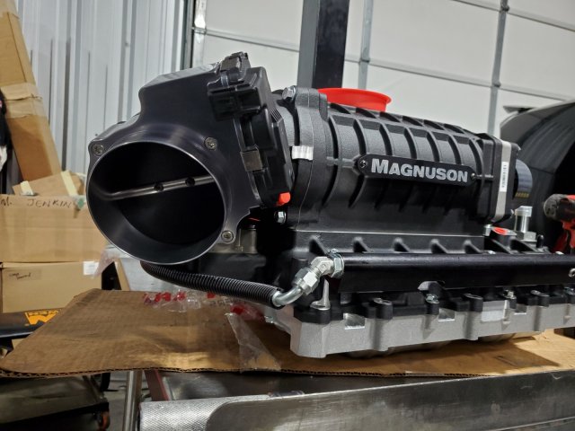

Update on the build: Car is in the shop having the maggie installed along with 1700id injectors, Big Jon Racing Idler kit, Fore Triple Pump, Gearhead Fabrications 108mm TB, Forced Induction Interchiller, light weight frt bumper support and will be tuned for Ignite E90

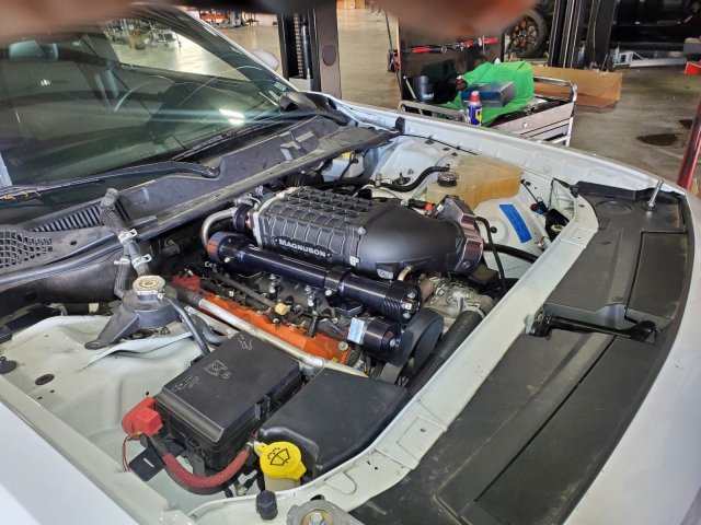

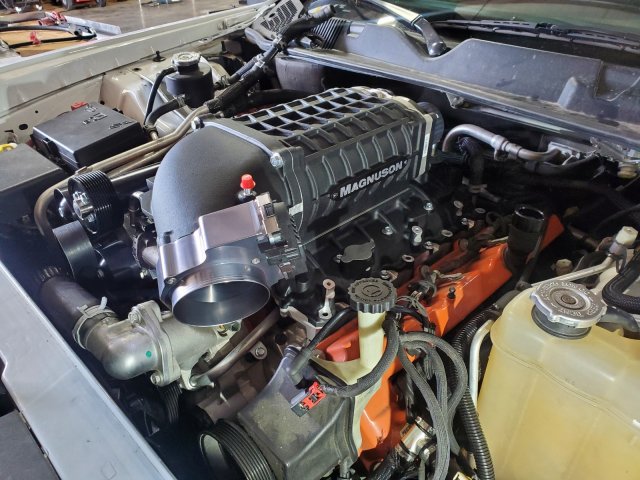

Making some progress on getting “Scarface” into the 9’s. 11011C1E-5347-47E8-9C0E-AF61E1233860.jpeg 3F73522D-1BD9-4481-9987-B8665508F5EC.jpeg 3F822174-AA37-4A45-AB7F-44A5C2158B90.jpeg

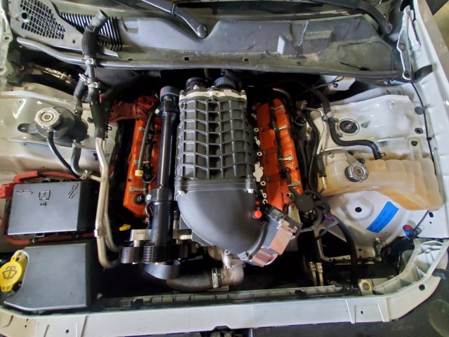

CB30EAE5-7590-4117-A90B-2B99858CA4C1.jpeg ABA64F73-0EA5-489F-8161-737245E85727.jpeg

Getting closer BEB4A7EB-DA71-4F04-854A-9AF4039FE796.jpeg 45A7D8AC-D758-41A9-A7BA-3B18DBA81D35.jpeg 690DF7A4-2FDB-4A9E-9CF6-6A386572C9FC.jpeg

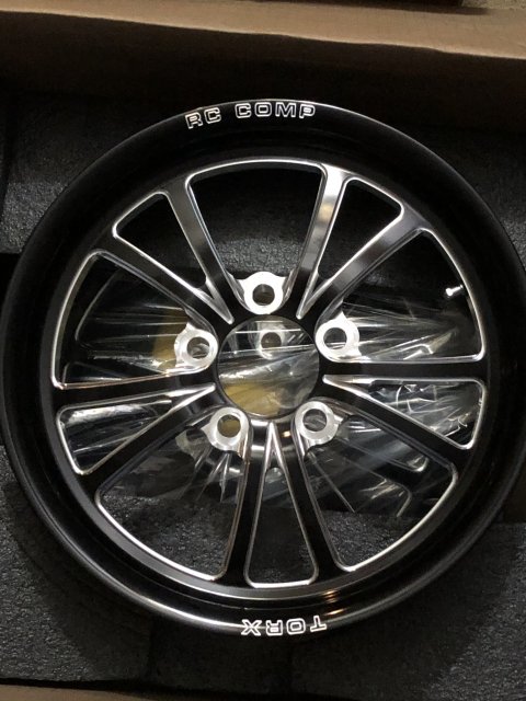

After nearly 8 weeks the RC Components 15x3.5”front wheels finally made it. 9917BD14-2DCA-4818-84FA-C7E79F6DF787.jpeg

Finally got the car on the dyno and tuned, we are still on stock engine internals, car made 917rwhp on 13 pounds of boost with the 3.5” pulley on the Maggie. Will probably leave it on this combo and get some track time until we get the new motor built.

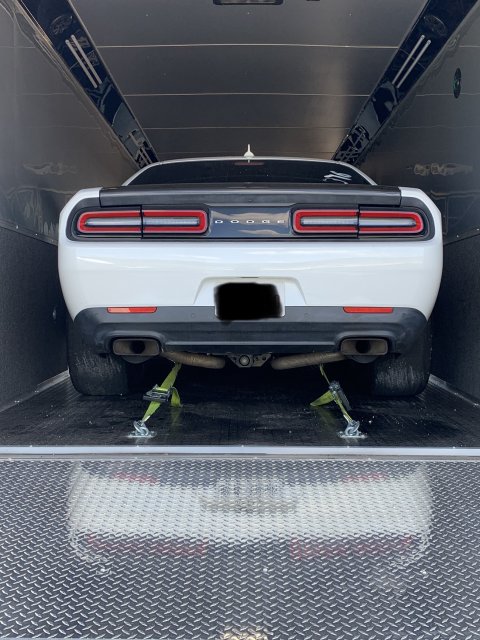

Loaded and ready to head out to World Wide Technology Raceway in Madison, IL on friday to try and get some data and see what Scarface runs. FB86889F-43F1-4DDE-AD45-B7A3ED4C547B.jpeg

I think it will be ok since I am only at 13lbs of boost currently. We ran it up to 6900rpm and it did not close shut. We will know for sure after the first burn out.
If I do have problems I will switch over to a cable TB and install the Holley Dominator ECU.

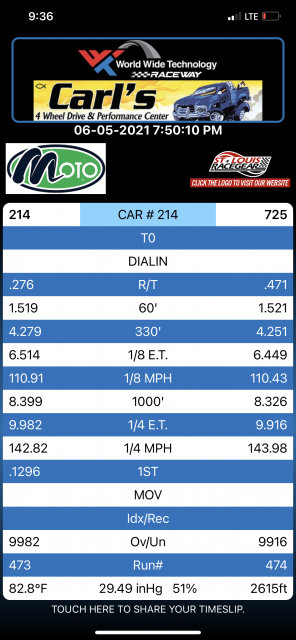

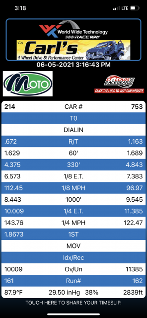

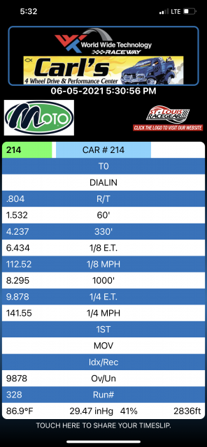

Made 4 passes this weekend on not so great track prep had to pedal it a little bit but did manage to set a PB. No issues with the VMP105mm TB, so will keep running it until we have problems. The FI interchiller was not cooling near as well as the last time out, so will check it for leaks and freon charge.
i am car 214
1st pass
2nd pass
4th pass
