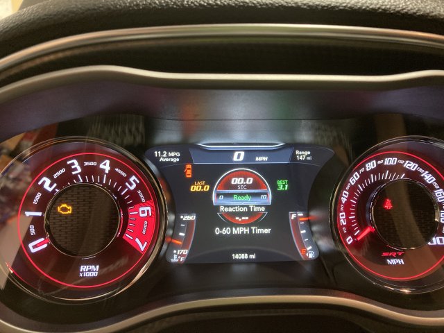

Update, drive to a car show today, send fine alignment wise but will schedule one for next Saturday. Body roll much reduced in conering. I only did a few mild hits on the way here, didn’t hop at all but my tires are at 33 psi hot yet, real test will be when I lower them to 26 and do a street 1/4 pull, maybe later today but I want to check over the security of the lock up bolts first which requires removing the tires. But so far so good. Can feel a bit more NVH but only slight. B0AFF03C-7CC5-42D6-B7C7-D39D4444FD75.jpeg

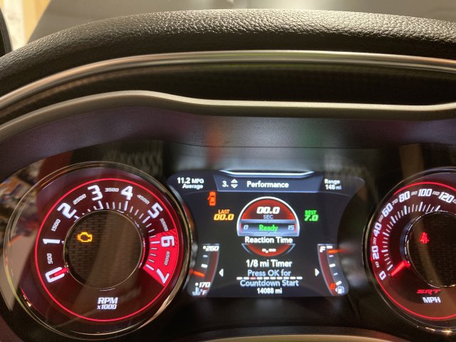

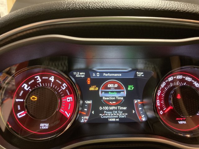

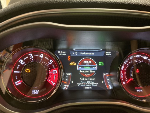

I couldn’t wait, no traffic, bridge to Mexico was all mine. Probably my best street 1/4 this season according to the car, battery positive just pulled while doing the work yesterday, my Gtech timer out for upgrade. It’s 88F here, Nitto NT05R at 32 psi and hot, no burn out. Spun in first and a bit in second peddling it but pretty impressed with the times. Now I’m home and will pull tires for inspection of arm bolts and for any rubbing. 273553CC-2B96-4839-AF3B-765FA8A02C6B.jpeg E84B904A-A3AF-4681-AC13-515EBD1FC8D6.jpeg 105B27F7-C813-4C3C-BF1E-F3E9324E671A.jpeg C6153C26-A5B4-4795-AA71-81FDF5C58A94.jpeg But here it is from the car timer.

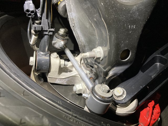

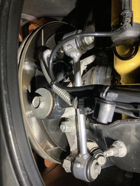

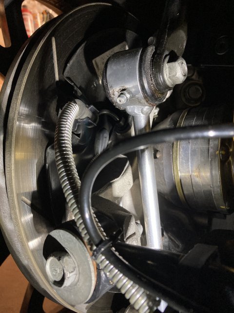

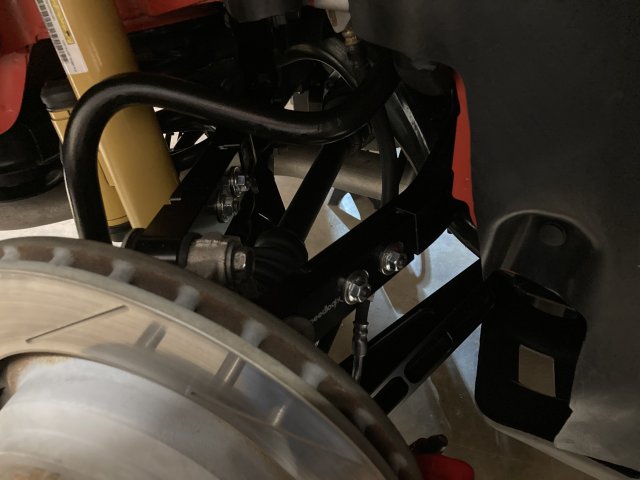

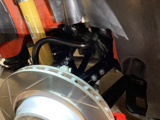

Man that looks close but if it clears it clears. I guess they are 1" shorter than stock according to an older sales page I found.
I need the end links before I'd need the arms. I should probably order the full set F & R.
3,320
7,835
These are 9” center to center, I think their 2” shorter then stock, measure yours and you’ll know. They don’t look like they could hit any where.
